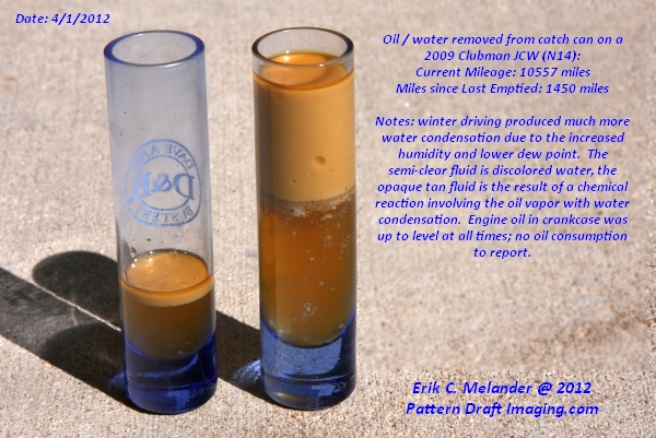

If I had stuff like this going on I would change every 5k no matter what anyone says... Its not about the oil failing , it's about the F.O.D. that can accumulate in the oil
think out of the box
