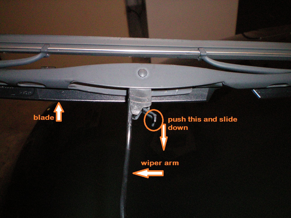

Is there some video i can see regarding how to detach the windshield wipers?

you mean get the blades off of the arms?
just push the little clip and slide the blade towards the arm base
apart it looks like
after market arms will have adapters in the package allowing you to fit the correct one into the J of the arm
OR are you asking about getting the rubber insert out of the arm . . .
