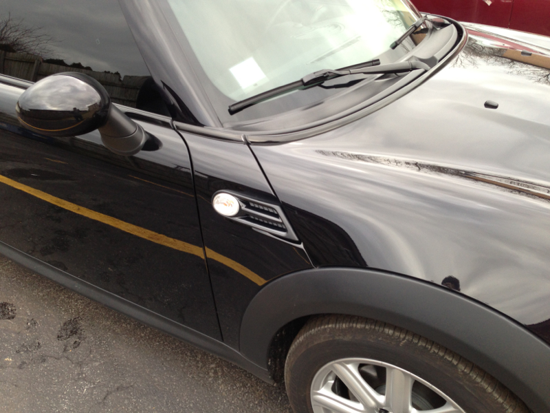

Thanks! i just swapped the side scuttles this afternoon from the factory S ones to the "Black Aero vent" ones that come on the new justa's...
