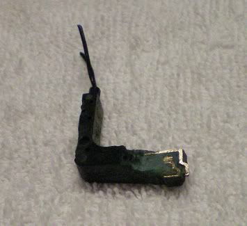

that DOES sound like the wear sensor may have been hit ... I'd do an eyeball check soon. If the pad material is not thicker than the backing plate it is time.
My warning popped up but eye ball said I was good and I reset getting 8000, I think the sensor was tripped tho which resulted in the 8k reset and once the sensor is tripped things count down FAST ... this is what I observed recently on my 7 anyway . . after I jumpered the worn sensors things reset to a much higher number that I don't remember (18,000?) . . . b4 folks tell me the sensor knows/reports how much wear... I've dissected one; it ain't that smart
Much different from a GEN1 that just had a sensor ... no miles counters ... or better yet an EARLY GEN1, my 02 had no pad wear sensors. And I've jumpered 'em out on my 07 now. Everytime I reset the counter now, it will see a complete circuit.
I got 45,000 out of the rear pads and 40k out of the fronts but fronts were changed to EBC Green at 5k just in case you wondered. I reset the counters once to full value after an eyeball check .. b4 the sensors tripped is my guess.
