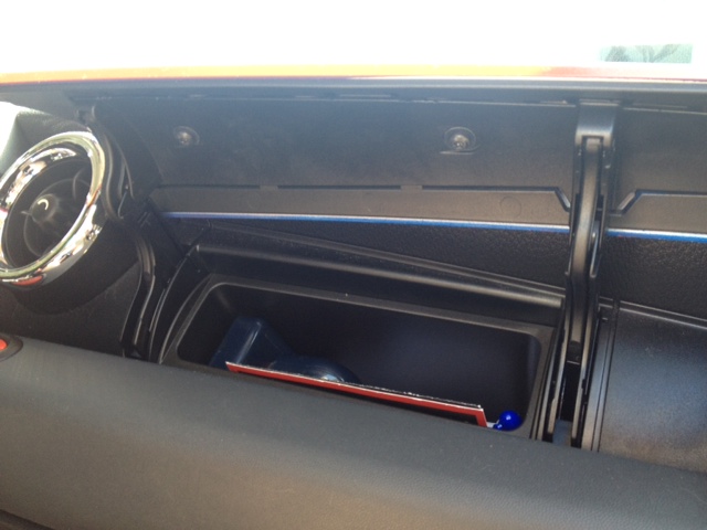

I took mine off and took photos of the removal. Here is what it looks like from underneath before the two Torx screws are removed:

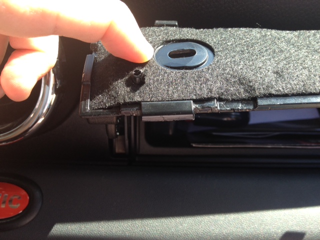

See that black line of separation up along the top (nearest to you)? You take a flat screwdriver and you have to twist it in there to pop it off of the three tabs on the front. In doing it, I found that you might not be able to succeed if you can't get something up in there. But if you want to try it, here is where the tabs are located:

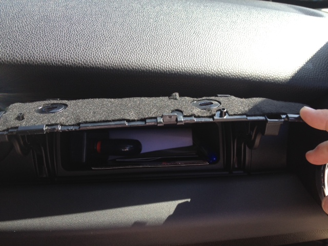

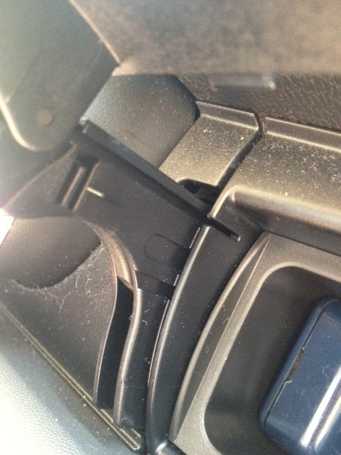

There is one immediately adjacent to the drivers side screw, one where my finger is, and one more in the middle. You sort of have to twist it so that the door moves toward you, and then pull it up and over the tab. It takes a bit of doing, but it does come off. Then you push it toward the dashboard, and it will lift off of the back tabs. Then your hinge looks like this:
Old Aug 31, 2012 | 11:06 AM
JoanieB's Avatar
JoanieB
Joined: Jan 2012
Posts: 1,007
From: San Diego County, California
The problem is, that the rest of that black plastic part can't be removed that I can see, so you don't gain a whole lot. It gives some more access to the hinges (which are what must be jamming) but I can't see how the hinges come out. Maybe the whole thing slides out somehow. Sorry, that's as far as I know how to go with it.
