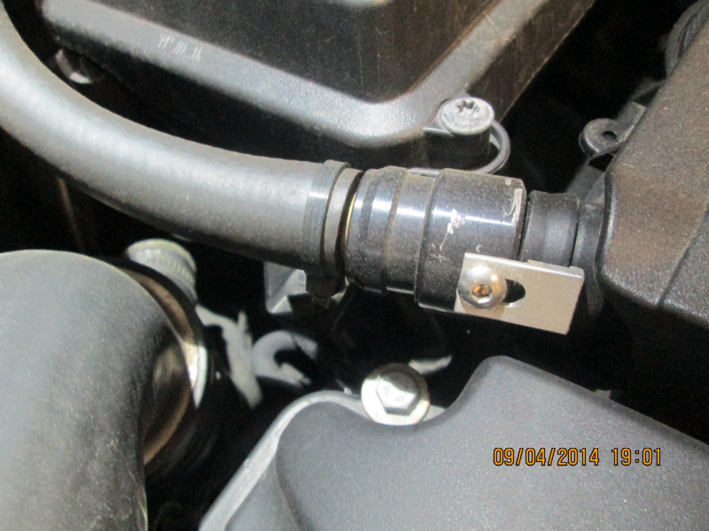

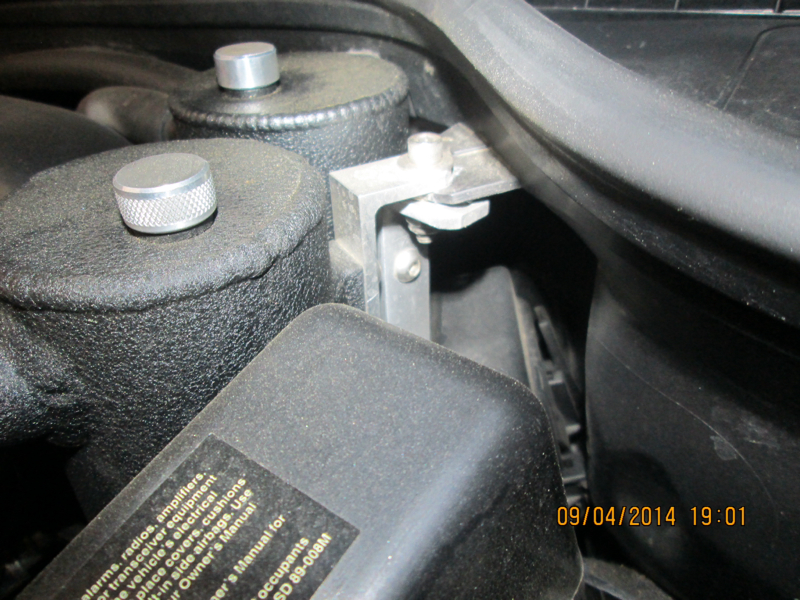

I have one on the driver's side, I do NOT want to block the passenger side PCV, and I would love to put a second OCC for that side, but I don't have a good spot to put it.
Can you post a picture of your setup? Thanks!
One can for each loop. One can for the passenger side valve cover to intake manifold & one can for the driver side valve cover to turbo intake.
They are physically mounted on the same screw w/ the supplied "L" bracket for each (my version of piggy backed). Sits pretty much the same as the Saiko twin can illustrated in the first link of my post above. Cozy but they fit w/ stock air cleaner housing.
Just for hahas I tried to configure the "noise maker" firewall duct to blow ambient air from the cowl onto the cans hoping to assist condensation but I couldn't come up w/ a good solution, it just isn't shaped right. I can't picture ever reinstalling the noise maker or throwing it away so I tried to use part of it but no success.
