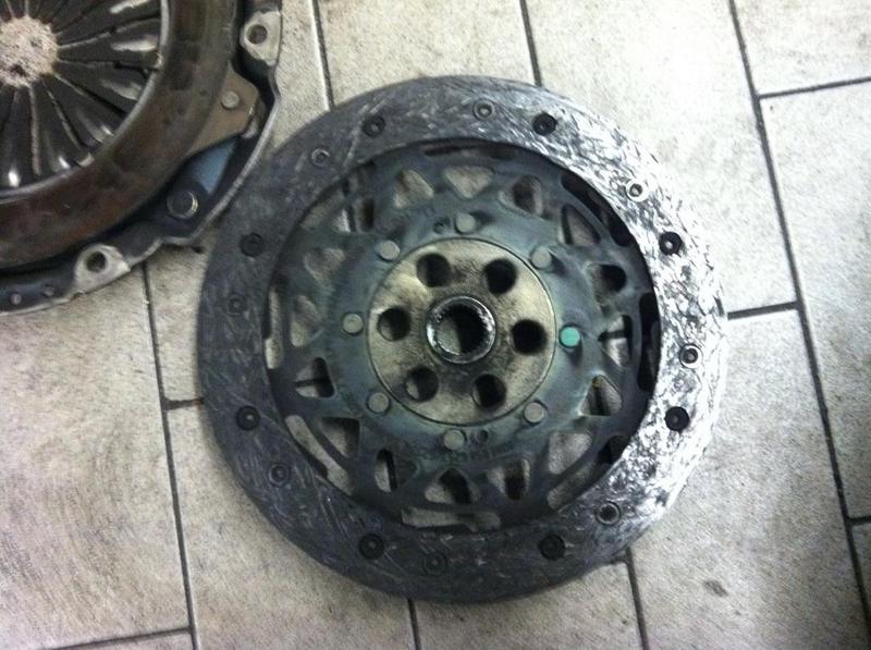

Anyway attached is some, not all, pictures of my old clutch parts that have to be replaced and cost me $3,500. The clutch is now smooth and light; it was never like that when I bought the car so it was probably already messed up. Here's the note in repair order.
Customer states the clutch pedal will not move. Worn out clutch assembly, scored flywheel, separated throw out bearing and fork.
Drained transmission fluid. Removed transmission. Removed and replace flywheel, clutch assembly, throw out bearing and fork lever. Reinstalled transmission, topped off transmission fluid. Test drove vehicle--transmission shifting properly on all gears. Vehicle operating properly at this time.
