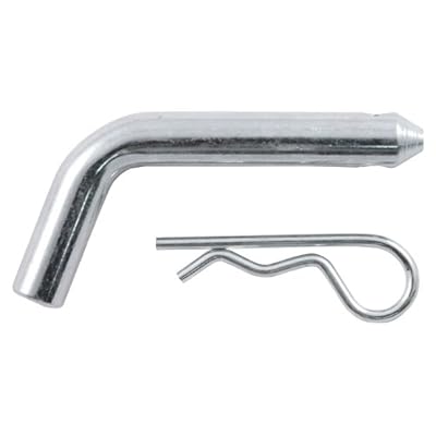

I read someone else's comment elsewhere about "threading the pin" and was confused... Do you mean threads like on a bolt? Does it not use a simple bent pin and cotter pin like this:

Do you use a traditional bent hitch pin with cotter pin, or something else?
Did you do any modifications to the receiver / pin / bumper to make installation easier?
The hardest part is getting the bumper insert out to expose the receiver (I reach under the bumper and pop it out from behind). It takes 30 seconds to a minute to get the drawbar installed. I only do it every couple of months, but it only took a couple of times to figure out a good technique. If I did it more often I would mark the drawbar with a piece of tape or something so I'd see exactly how far to insert it into the receiver to get the holes to line up. Then the process would be even faster.
One thing that does make it easy is the pin that came with my drawbar. It's the one on the far left of this picture:
It doesn't have a separate cotter pin, so ther's no fiddling to find the little hole to stick the pin through. That probably makes all the difference in the world.
