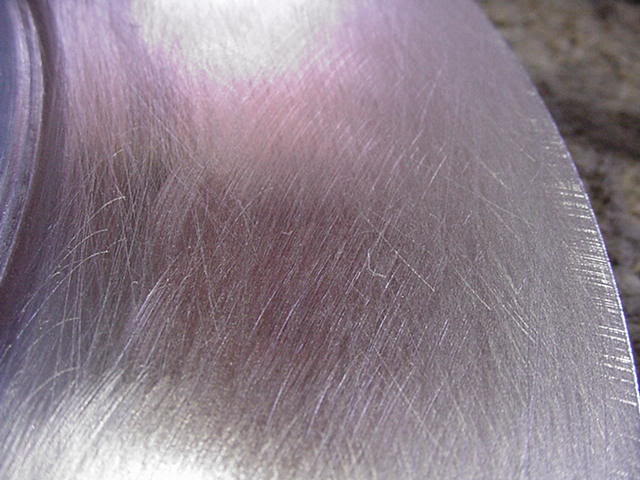

Remove the wheels and use some 220 grit sandpaper to rough up the rotors (just the inside and outside of each disc where the pads make contact). Basically just knock the shine off of them using either a criss/cross pattern (going around the surface at 45° to the radius and then going back again 45° in the other direction) or overlapping circular motion (ie: small circles all around the perimeter).
They should look somewhat like this when you're done:
