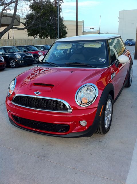

ya that looks so good! heres what mine looks like now... i think it would look good with those stripes!
Old Jan 3, 2011 | 01:37 PM
Archambaultt's Avatar
Archambaultt
Joined: Jan 2011
Posts: 24
From: Wolcott, Connecticut
you should totally go for it.. just take your time, and it will come out great
