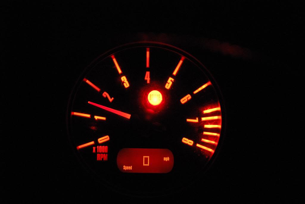

I know its a old thread but i just did my needles in red, however it wont show up very well in pictures cause i am a poor photographer

As for the lights in your gauges, they are Surface Mount Technology LEDs or SMT LEDs. Very tiny and not really smart to mess with if you have no experience with them unless you like the cost of new gauges to try on your own.

I know they are Plcc-2
and they are a huge pain to deal with but i think the result is worth it.

From what I've seen, they look great when completed. Also, the needle is orange and needs to be painted
Old Apr 5, 2013 | 09:35 PM
ColinGreene's Avatar
ColinGreene
Joined: Jul 2011
Posts: 435
yeah the needle is orange, i used nail polish remover to clean the orange paint off the back
then red model paint to paint the needle red.
but without changing the root Led they would still light up orange at night.
