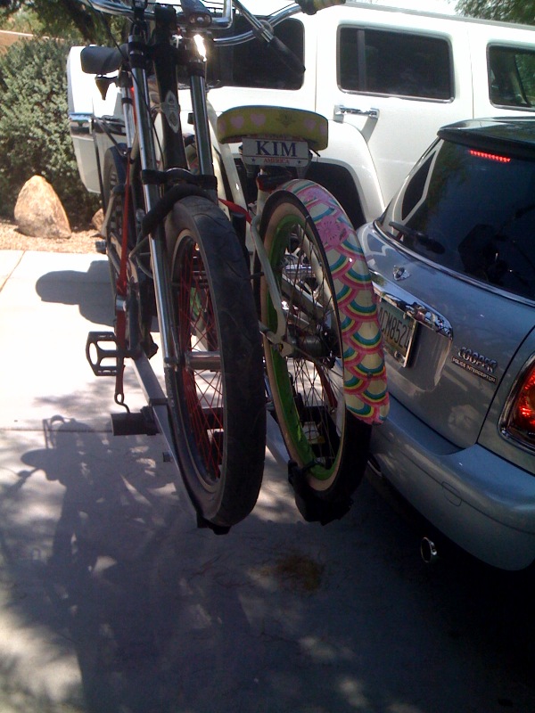

Just installed the MINI DO MORE hitch and Thule T2 rack. Carried both beach cruisers to the beach and it worked great! Hate the screw in bolt so that will have to be changed. And when the racks not on, I can pop the little black plastic cover back on and no one knows I have a hitch.
