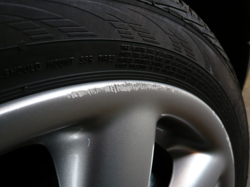

Well had my first case of curb-rash already . It's not a pretty sight, although it looks worse in the photo than in person. Can I use some fine sandpaper or Emery Cloth? Do I need to redo the clear-coat? Or should I use the Wurth German Alloy Silver Wheel Lacquer?
I don't want to start spraying the entire rim, I just would like to touch up the part that got hurt.
If I leave it, other than asthetics, will that cause a problem?

Light sanding then touch it up. You will get more in the future.
Try to find a clean one someone has taken off and use this one as the spare wheel.
Not nice to get curbed, but it happens.

With the touch up, is there any silver paint that's a brush on? I have such a small area I'm worried that if I start to try to spray and it runs I'm just going to end up with an even worse problem

You can probably get wheel touch up in the bottle at your MINI dealer.
Another way would be spray the color into a container then dab/touchup from container before the paint dries.
I would not spray the curb-rash directly, it will run as you noted.

i would just leave it..... as others have said you will probably get more over time. There is plenty of info on the web about how to repair it, but it is a pain staking process. A little curb rash won't devalue the car, and it doesn't really spoil the looks of the car either.

Ask your dealer about there process. I had a rim that they fixed and it looks brand new.

If you end up repairing it yourself, the spot putty method is pretty easy. I would only add from my own experience of doing it that if you have a really high spot where you scraped the wheel, take a file to it first before sanding it down and applying the putty, otherwise you will have a hard time getting it smooth and even.
I did a whole set of four wheels and all had extensive rash (from the previous owner). It took a while.....but one little spot like you have should take no time at all, especially since you would just tape off the one spot and touch up with the spray paint.

For painted and clear-coated wheels, the following link is probably a similar technique used by dealerships to fill curb-rash and refinish the damage. I hope you're feeling ambitious (although seriously, it doesn't actually look too hard if you take your time. Perhaps this would be a good technique to wait and try if another wheel were to get damaged.)

...seriously, I had a rock smack my newly powder coated wheel, left a big ding/chip. I sprayed paint onto a wire and let it run down into the damaged area, filled it up nicely. On your's you may need position the scuff down and mask the tire below the area. Take your time, and from ten feet, good as new!

Thanks everyone for the great advise. I think I will give it a try with the DIY repair but I'll wait til the summer. Perhaps by then I'll be less in shock about Spike . Also right now it's too cold where I am. As I often say, why do today what you can put off 'til tomorrow.

If you are were looking to change to some non runflat tires, you can get new, wider tires. Stock is 205, I've gone to size 215 tires myself. This will offer a bit of protection as the rubber comes out past the rim. Save your old tires in case u get a flat. Or if you were looking for new rims, same rules apply.
