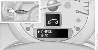

I don't know if holding it down when you start the car displays them automatically or not, but you use momentary presses of the button to cycle through the options and holding the button down for a bit to select.
The 08's manual isn't available as a PDF yet, but the 07 hardtop is, and it's basically the same for this particular issue. The check control messages part is on page 51 of the manual (Adobe Reader considers it page 53, since it includes the cover pages)
It looks like serious messages don't go away and won't be dropped down into just the lower odometer box:
Some Check Control messages remain visible
until the respective malfunction has been rectified.
They cannot be hidden. If several malfunctions
occur at the same time, they are displayed
in succession.
Here's the relevant bit from the manual, note the existence of the elusive low washer fluid indicator
Other Check Control messages are automatically
hidden after approx. 20 seconds, but remain
stored.
This symbol indicates that Check Control
messages have been stored. Check Control messages
can be viewed whenever it is convenient.
Viewing stored Check Control messages
Stored Check Control messages can only be displayed
if the driver's door is closed.
1. Briefly press the button in the turn indicator
lever repeatedly until "SET/INFO" is displayed.
2. Press and hold the button until the display
changes.
3. Press the button repeatedly until the display
shows the corresponding symbol and
"CHECK INFO".
4. Hold the button down.
"CHECK OK" appears if there are no Check
Control messages.
If a Check Control message has been stored,
the corresponding message is displayed.
5. Briefly press the button to check for other
messages.
Attached Thumbnails Never Before Seen Warning Light!!-checkcontrol01.jpg   Never Before Seen Warning Light!!-checkcontrol02.jpg   Never Before Seen Warning Light!!-checkcontrol03.jpg
