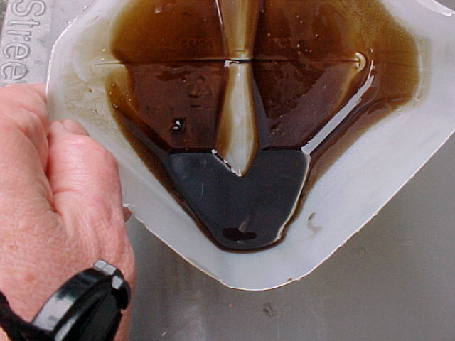

Griots Oil Extractor RESULTS Photo
I have been doing the oil changes on my 07 MCS the regular way, even though I'd bought a 6.8 quart extractor from Griots Garage a couple years back. I finally decided to give it a try. It was easy to use. I ran the engine for FIVE minutes only prior to extracting, and the oil came out warm. I did have to move the hose around a bit to get the job finished up. I had a magnetic drain plug to install, so I cut a gallon milk jug down and slid it under the pan to catch any remaining oil. When I pulled the plug, I was pleasantly surprised to have only a few intermittent drops of oil fall out. Then I decided to jack up the drivers side a few inches, and I DID have a small amount come out. I'm trying to attach a photo, but in case i doesn't show up, the amount was two to three tablespoons of oil. I MIGHT have picked this oil up if I'd jacked up the driver's side prior to using the extractor. I found that I wanted to turn the extractor hose so that it was curving over toward the side of the pan where the drain plug is. Anyway, imo, the pump worked great. I'm not going under the car again except to check what that magnet plug picks up after a couple of more oil changes.
I just switched to Redline 5/30 full synthetic. I ran factory recommended Castrol the first twenty thousand miles.
BTW, I'm still loving my Mini just as much as the day I picked it up. It's a terrific little car.

Old Jan 12, 2011 | 05:00 PM
pheatton's Avatar
pheatton
Joined: Dec 2010
Posts: 626
Thats not a lot of oil left in the pan...
Might look into one of these.
