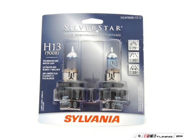

I have used the Osram silver star and they were closest to white / clear. 4000k on the scale.
https://www.ecstuning.com/Search/SiteSearch/H13ST/

Just bought 9008/H13 Sylvania Silverstar Ultra from auto parts joint $40.00 4100K 325hrs
we shall see I Hope...

I have used the Osram silver star and they were closest to white / clear. 4000k on the scale. https://www.ecstuning.com/Search/SiteSearch/H13ST/
also use these, I've had them for at least a year.

Be careful. In trying to find something brighter I bought these and someone warned me a year later. I looked at the lenses and sure enough they were checked because the bulbs run too hot. I couldn't buff out the problem. Sylvania was also sued about their claims.
Here's the result of over a year of SilverStars

Silverstars vs. others
I have had no problems with Sylvania Silverstar Ultras. I did have a problem with some "brighter" and higher wattage bulbs that I thought would give more light. I think they were 85/100w. They seemed to be a bit brighter, but after a very short time, they also left burn marks on my reflectors in my halogen headlight assemblies! That was nice. They also melted my headlight connectors to the point where at times (even after re-installing the Silverstar Ultras) I had to smack my right headlight to make it come on again. Not doing that again! I have now cut my original melted connectors off, and have soldered new connectors into place. Now running Phillips Extreme Power, IIRC. Who knows? I change headlight bulbs more often than my underwear, looking for something to get close to matching my LED DRL and Fog light bulbs. Not gonna happen until I go HID kit, or LED. Have tried both. HID kit simply would not work on my 2011, the FWM freaked out big-time. LED's? Tried. Same result with FWM, and no high beams even when the lows worked for a very short time. I guess it's down to the factory Xenon upgrade for $1200.00, or the Spyder units, which I still cannot get an answer as far as if they have solid high beams, or only flash-to-pass function. Can anyone with the Spyder lights confirm that the high beams stay on in a 2011? I need high beams, as I live in the middle of nowhere, and drive twisty-turny mountain roads every day and night.

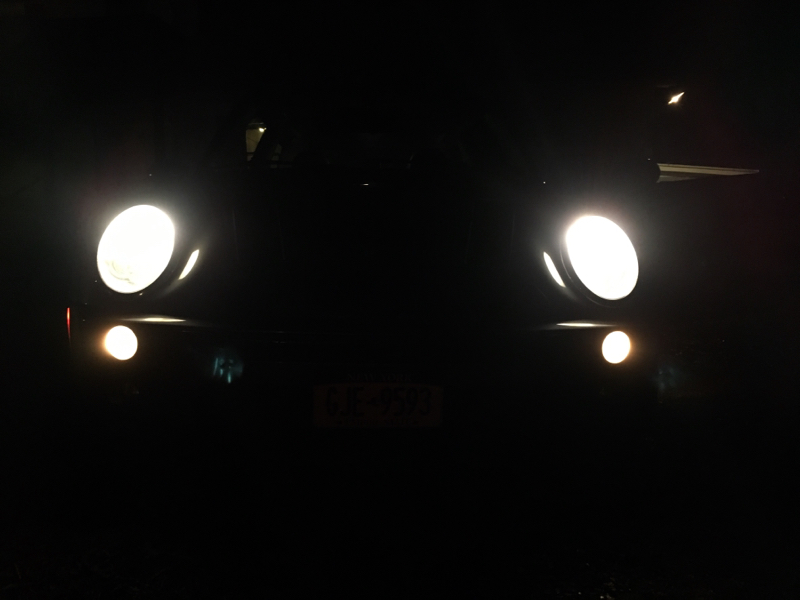

Just put some Zizas in from ECS tuning, I'll let you know how they work out.
Attached Thumbnails Any brighter bulb option for standard h.lights?-image-2604705591.jpg

Nice, thanks for the order.
