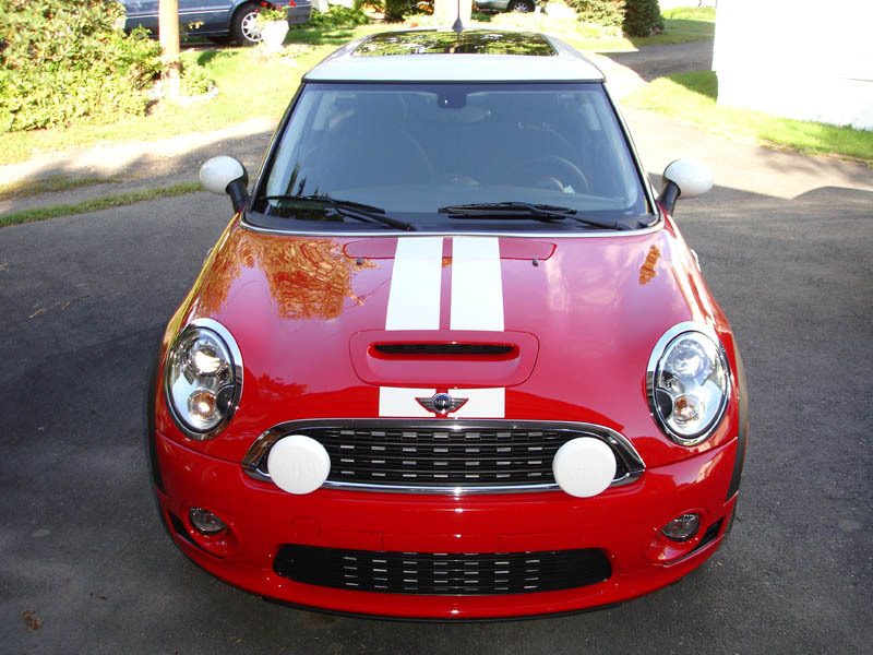

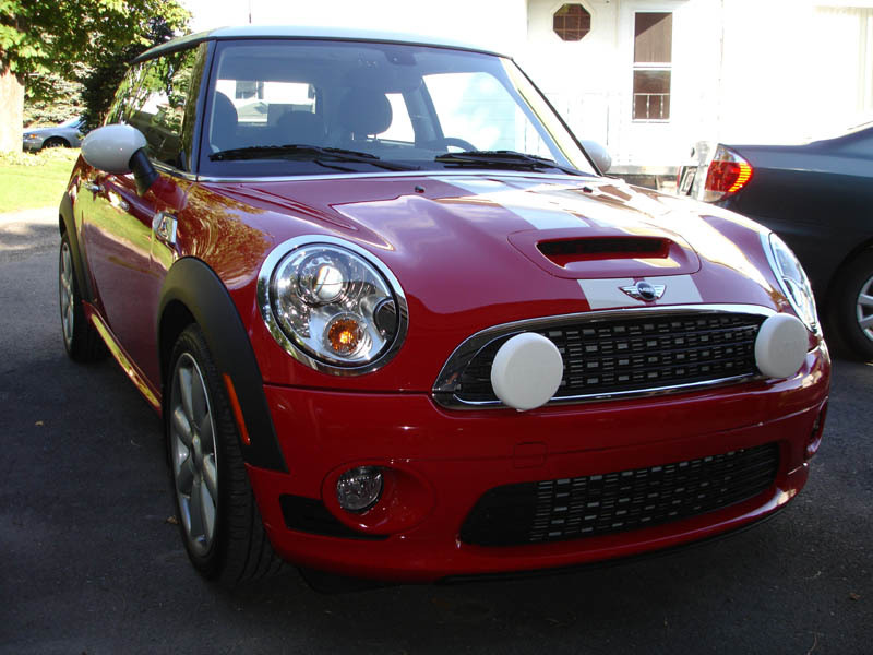

I have it and I love it. To me, it looks much better in person than it does in pictures. To each his own, but I've got nothing but compliments on it since owning it. I think the standard look is rather plain and not sporty enough for a little hot rod like the MINI, but that's just me. The JCW is nice, but I don't care for the rear on it much. My only regret is not getting the rear fogs. Forgot to add them and didn't realize it till it was too late.
Attached Thumbnails Sport Suspension VS. Stock Suspension-dsc00461.jpg   Sport Suspension VS. Stock Suspension-dsc00456.jpg   Sport Suspension VS. Stock Suspension-dsc00455.jpg
