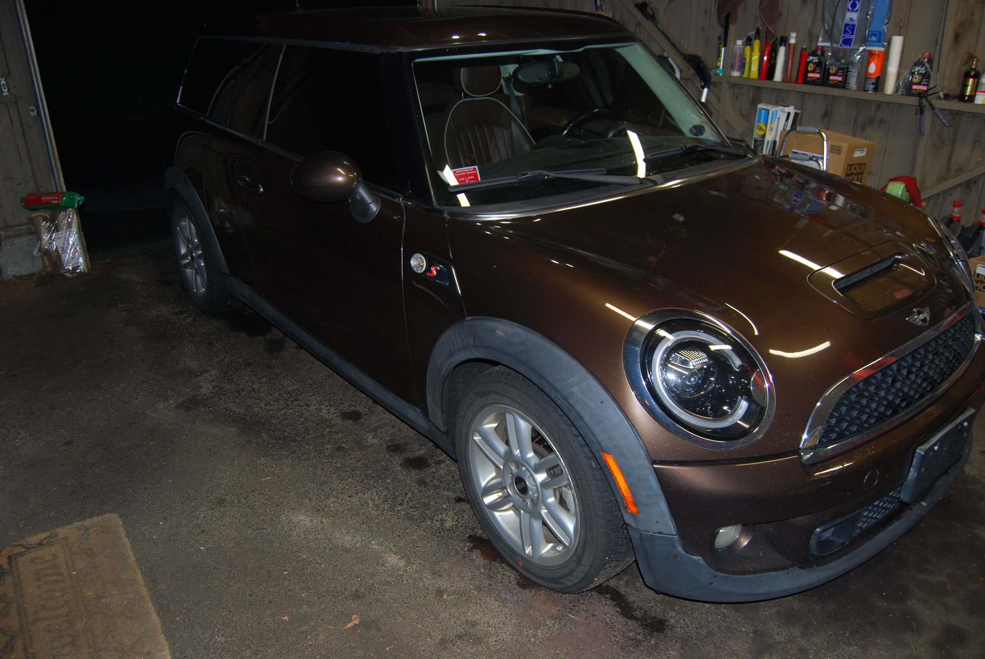

From the day of the test drive:
I test drove a 2013 R55s JCW the same day. There's a part of myself that regrets not buying that car - it remains one of the only JCW clubbies that I've ever seen with an N18 motor, had the factory grey faced gauges, and was sitting at 73,000 miles. But the dealer wanted $4500 more for it, and it lacked the lounge leather interior.

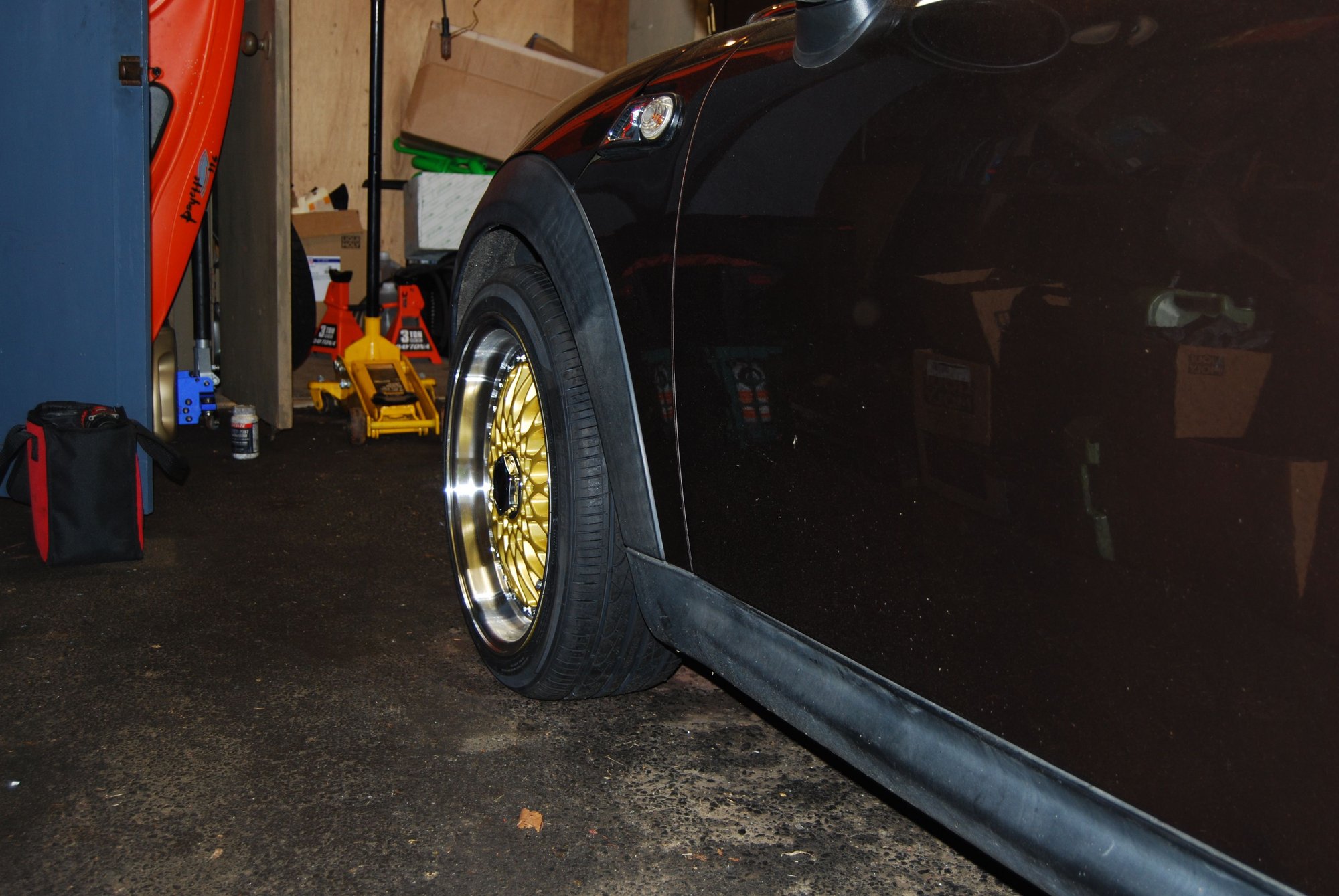

Had been getting a clunk coming from the back end of the car which started shortly after the Minis at the Glen last summer. I suspected it was a bushing problem (isn't it always a bushing problem?), but I've never actually replaced the bushings in one of these cars so wasn't entirely convinced right away. After checking the other obvious things - sway bar links, struts, etc. - I couldn't avoid the conclusion. Of course I wanted to upgrade to polyurethane if I'm doing all the work, but whoa.....sticker shock for Powerflex. Did a little looking around and found PSB (Problem Solving Bushings), and decided to give them a whirl. So ordered up all of the bushings for the entire car, and then life kept getting in the way. Work, winter, and here we are. By the time mid April had hit, it was really becoming annoying, just a constant knock all the time, mostly from the rear passenger side. So I pushed everything out of the way, cleared the weekend schedule, and dove in Saturday morning....
Heading in on Friday night, time for the suspension refresh

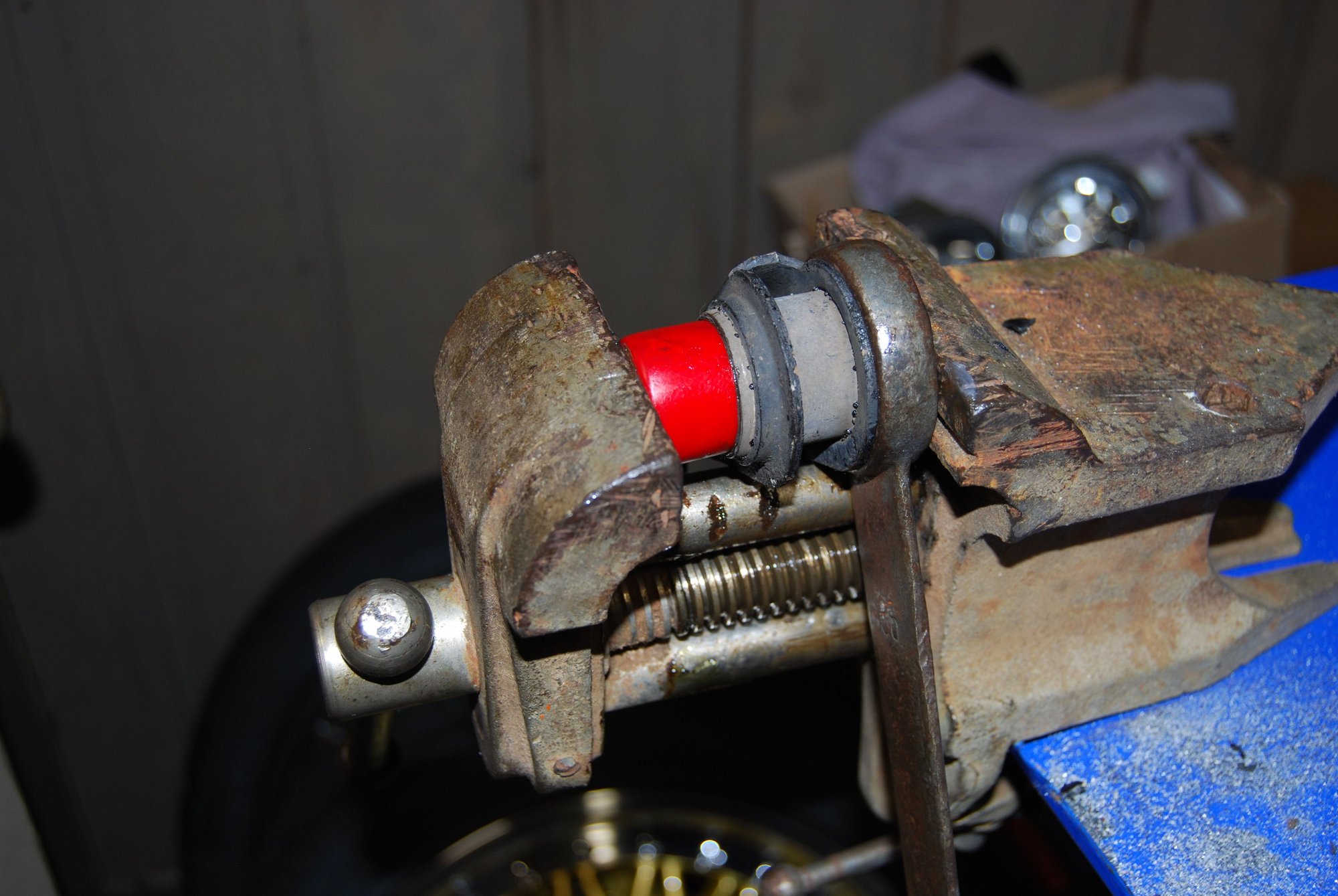

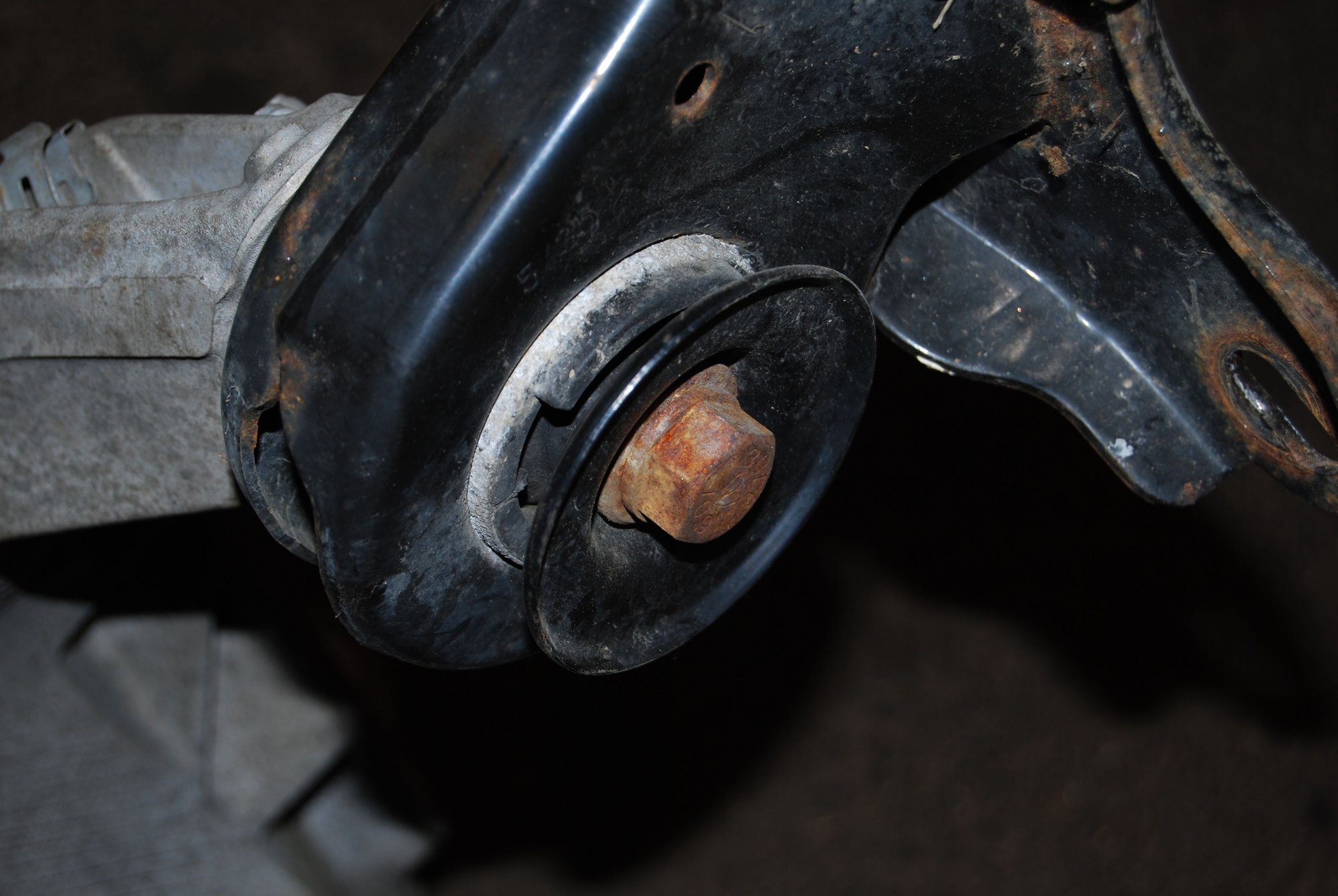

Next I moved on to the control arms. I decided to drop the subframe before removing them - as it was going to be necessary to replace the stabilizer bar anyhow. There's not a ton of room up there to access the bolts for the inner ends of these, and I thought any extra room would be helpful. Some videos/sites will tell you to remove the exhaust here, in addition to the heat shield. I'm working on a blacktop garage floor, no lift, by myself......I do not want to remove exhaust unless I have to. So I just dropped the driver's side down at the rear hanger, and removed the rear heat shield section. Totally fine, gives you plenty of room. Subframe is only 4 bolts, came right down, and on to the control arms we go. And here is the source of all the clunking....
Qualifies as shot
Qualifies as shot
All 4 inner ends were worn. The removal presented a puzzle, but found a good use for the screw extractor set in the toolbox. MAPP gas was plenty hot enough to heat the bushing up enough to rotate out. Installation was a snap using a bench vise and an oversized box end wrench as a spacer, after cleaning up the inside with a wire brush on the drill.
Use plenty of lube!
Use plenty of lube!

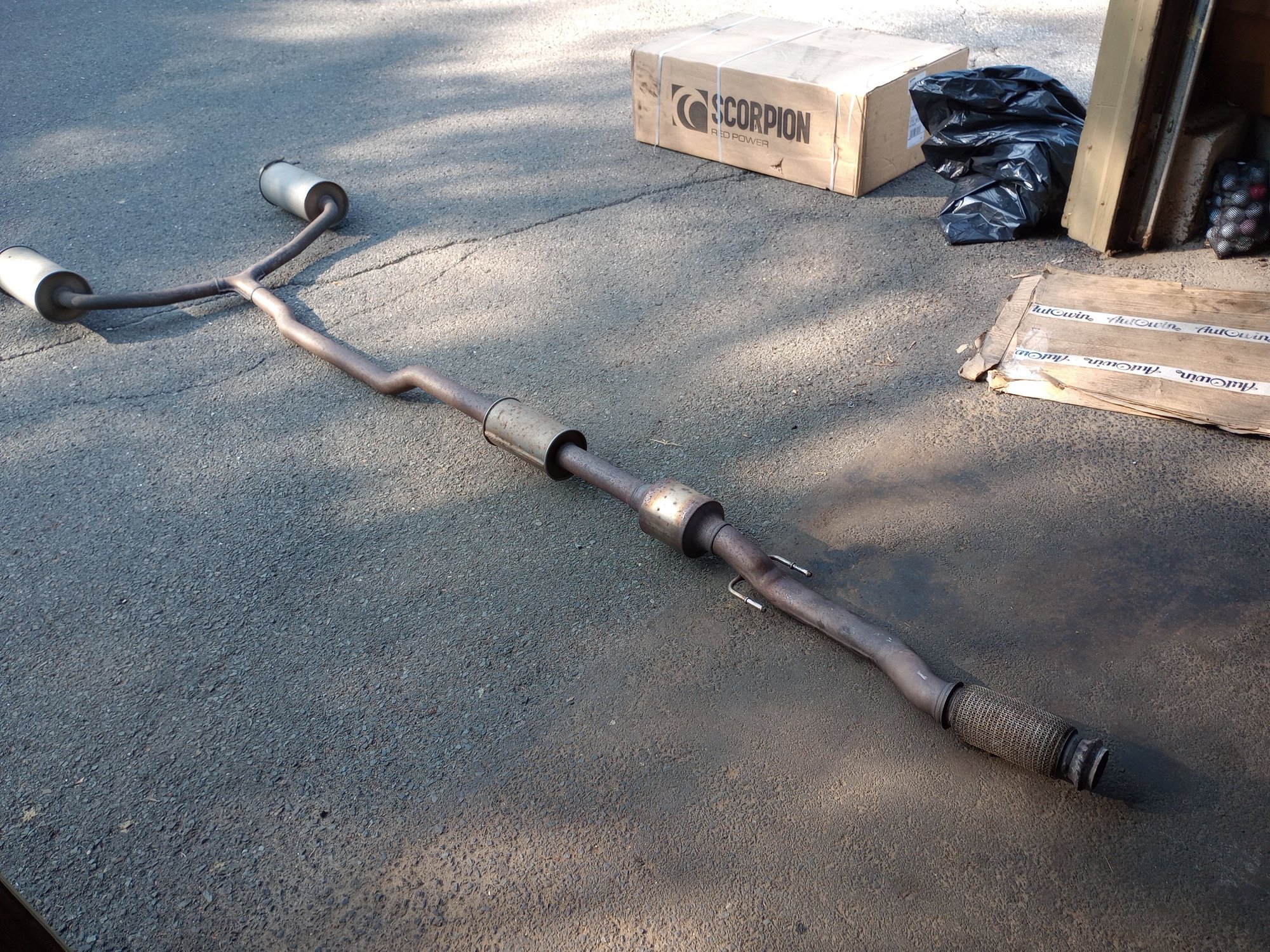

So the fun continues!

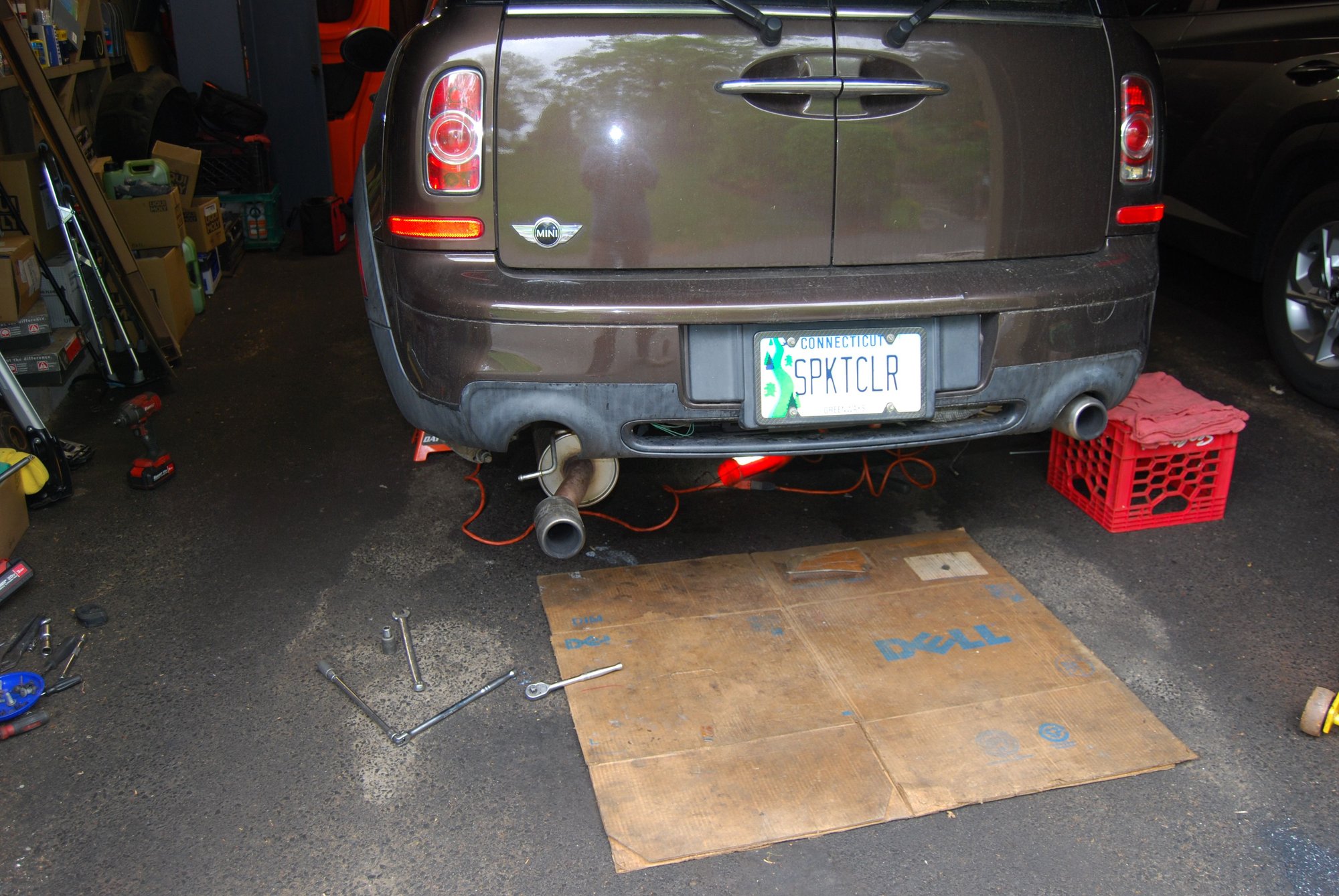

Last night was time for a FUN project - installed the Scorpion Red Power sport exhaust, and thanks @ECSTuning again!
I've wanted a 'sportier' sound for quite a while, but things kept eating up my fun fund...finally got to the point where I could go for it. Decided on the 'non-resonated- version, in addition to saving a few bucks I thought I'd be happier with the sound.
Old exhaust off, that was much easier than I expected
I neglected to take pics of the new system as I was unboxing. It's multiple pieces - a pair of mufflers with nice, large tailpipes, a front flex pipe, and 2 center sections. There was no way I was going to assemble beforehand and install on the car - I don't have a lift - so installed from front to back. After everything was in place, I adjusted and lightly clamped to allow final fit. Went together really well, and no adjustment was necessary.
