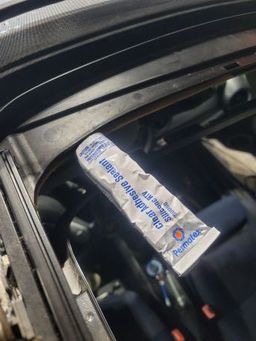

After viewing posts on NAM, there are many reasons why rattling noises occur around the sunroof area. In my case, it was the following:
Issue: Persistent rattle noise at front right/left corners of headliner near sun visors. Occurred from vibration even on a smooth roadway or by tapping the frame surround with a finger.
Survey (below): Rattle could be dampened by pinching down at straight arrow and up at opposite point on headliner inside the car.
Problem: plastic headliner standoffs sandwiched between the headliner and plastic sunroof surround (mounted to roof of car) were unglued from the headliner. (see realoem photo below)
Plastic standoffs are circled. They are glued to the topside of headliner. Adhesive had failed in my MCS, causing them to rattle against plastic roof supports for sunroof frame.
Remedy: Removed sunroof trim piece to access the standoffs and applied adhesive (with extension nozzle) between the plastic standoff and the headliner.
Prep time: Overnight (16 h) with clamping. Note: the adhesive shown works on plastic and fabric while remaining flexible/pliable.
Outcome: Rattle has ceased.
