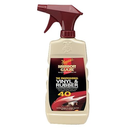

Why not lube the plastic slides with some rubber / vinyl treatment......
Rather than throw out the baby with the wash (we LIKE the screens even with added tint).
