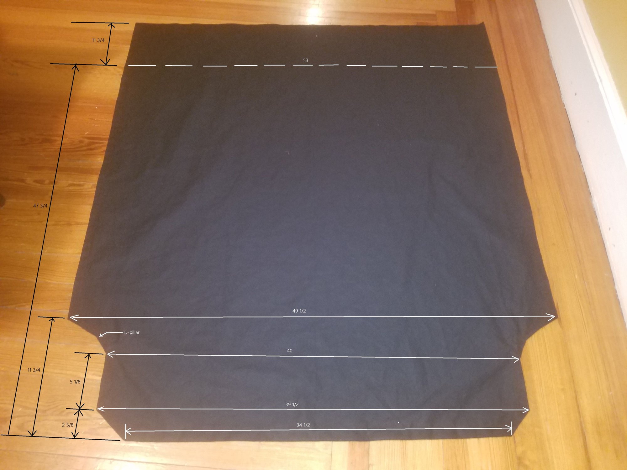

Here are the dimensions of the cover I made:
The only tricky part was where it goes around the D-pillar (or is that last pillar considered the C-pillar? I guess it depends on which side of the car you're looking at ). I tried to make it kind of curved there.
I just made it straight on the passenger side where it goes past the C-pillar. I think it works well enough. You can see what I mean in the photo in my original post.
The other thing to note is that the part above the white dotted line just drapes down behind the front seats. It doesn't go all the way to the floor, but it goes low enough so that you can't look in the window and see what's under the cover. If you've removed your rear seats, you may need to make that part longer. Or, if you don't care so much about total secrecy, you can just end it at the dotted line. That's where it folds.
Let me know if you have any other questions.
