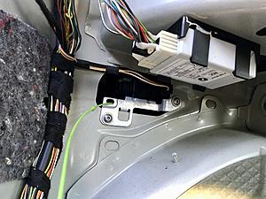

ECSTuning was 100% correct. I removed the driver's side rear panel and the actuator is mounted just above the wheel well.
