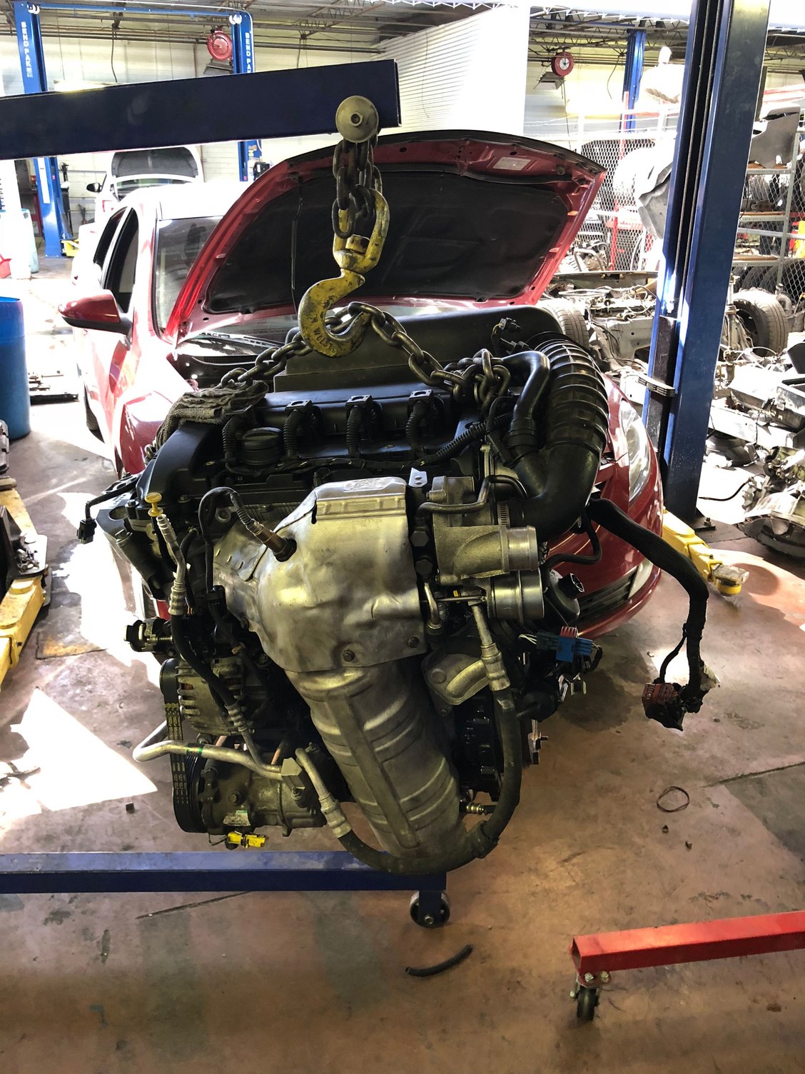

Today I finished assembling the block I installed pistons, oil pump, and oil pan. I still need to install 7 exhaust valves into the head and that will be done. I just ordered the turbo oil supply line and oil cooler gaskets once those arrive it should be ready to drop back in the vehicle.

I finally got the cylinder head put back together and installed on the block. I need to torque the head bolts and install timing components then it will be assembled and I can start transferring all other parts

The head is torqued down, I got the timing all set up, and I’m transferring everything else now. I also received my new clutch. I should be done and ready to drop it in soon

Today I got the drivetrain assembled and dropped in. Hopefully I should have the vehicle assembled soon

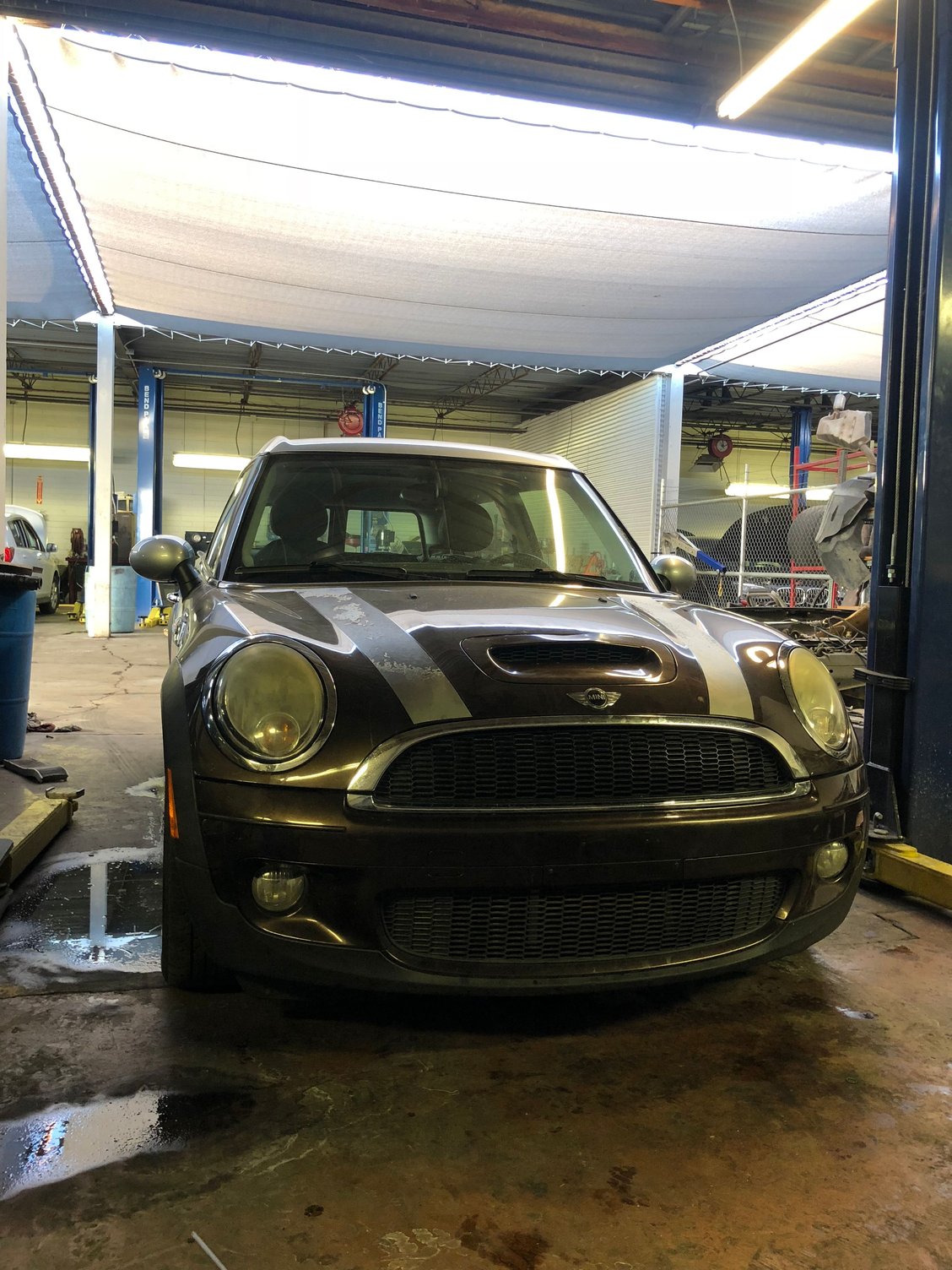

So I finished everything up this last Friday and have been driving it all weekend I’ve put about 250 miles on it and everything has been great! My girlfriend and my dog both love it. Now it does need a few other things like struts, brakes, and tires but they’re good enough for now all that will come soon

still running great no leaks or issues so far
I put r85 wheels on it with bf goodrich 215/45/17s
i also got the f56 style headlights which I think look amazing. I still need to get the windows tinted and the hood stripes replaced
