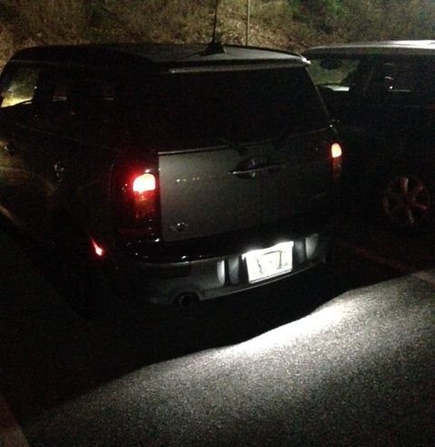

I bought these error free LED 194/168 size bulbs off Amazon and they fit the sockets and fit in the license plate light housings. I have not gotten any errors or bulb out notifications.
JDM Astar - 5000k color "Xenon white" and rated at 360-400 lumen output
Amazon.com: JDM ASTAR Extremely Bright Canbus Error Free 3030 Chipsets 168 175 194 2825 W5W T10 New Style LED Bulbs,Xenon White--Brightest T10 Bulb on the market and 2yr Warranty Included: Automotive Amazon.com: JDM ASTAR Extremely Bright Canbus Error Free 3030 Chipsets 168 175 194 2825 W5W T10 New Style LED Bulbs,Xenon White--Brightest T10 Bulb on the market and 2yr Warranty Included: Automotive
Below are some pictures. While I like the white color of the bulbs, these are insanely bright. As you can see from the pictures the light pools on the ground the entire width of the car. One bulb would probably be more then enough and 2 of these makes it look a bit ridiculous. I'm not sure how long I'll run them since it's not really the look I was going for. Anyone know of any error free LED bulbs with less output? Should I just go with some ultra white halogens to get the color I want but not the extreme output?
