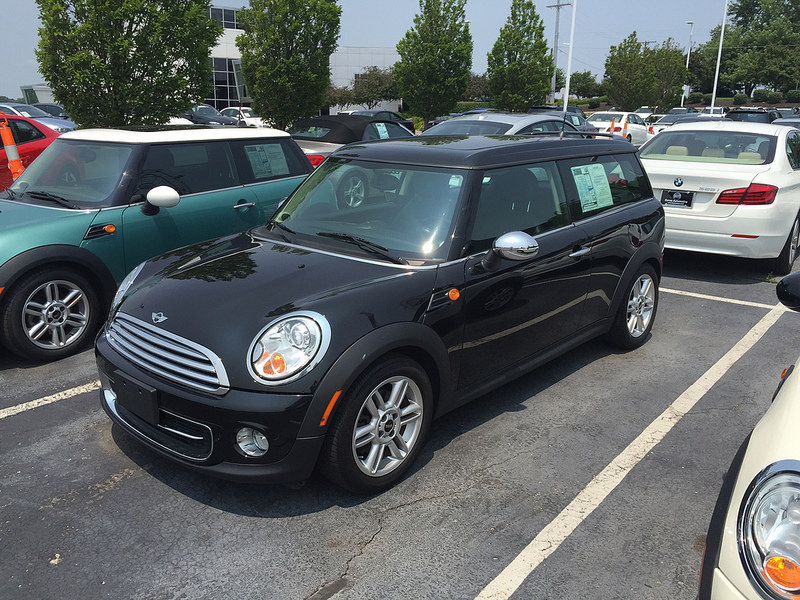

Seems like a lot of people are new owners of Clubbys. I just bought on the 4th of July a 2011 Justa Cooper Clubby in Midnight Black.
Previous owner actually bought it through Military New Car Sales in Germany and shipped it back a few years later so the car has a handful of Euro options on it, supposedly. Good looking car overall and I'm hoping there are a few little things that I don't know about the R55 that people might be able to tell me.

@Zackattachk28 - since you have the Euro version of the mini, do you have the hazard triangle in the boot? Also, did it come with the First Aid kit, or any tools for fixing a flat?

+1 what does it have in the boot area ?
