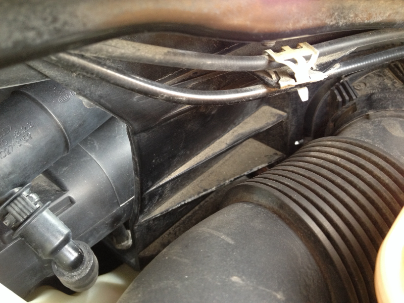

Old May 23, 2014 | 11:17 AM
trev_penney's Avatar
trev_penney
Joined: May 2014
Posts: 6
Originally Posted by danjreed
Here ya go.
there is no ground here.
