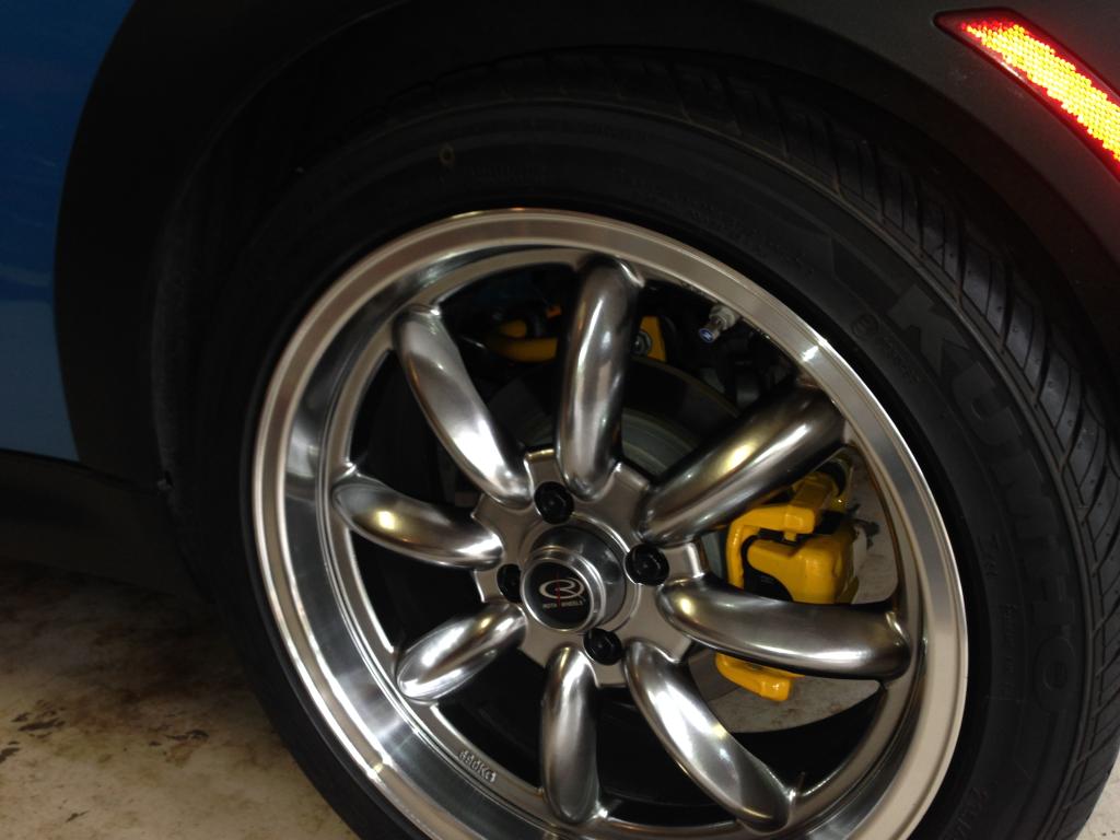

Ok I scored a 18.5 jcw bar for $20 and spent $40 to powder coat yellow to match my calipers, spent 2.5 hours by myself and very happy with the results, tight turns don't seem nearly as tight. I think it was worth the effort.
Had I known you could source a JCW rear sway for $20, I would have said do it ASAP! Crazy price.
And that paint job ain't too bad either!
