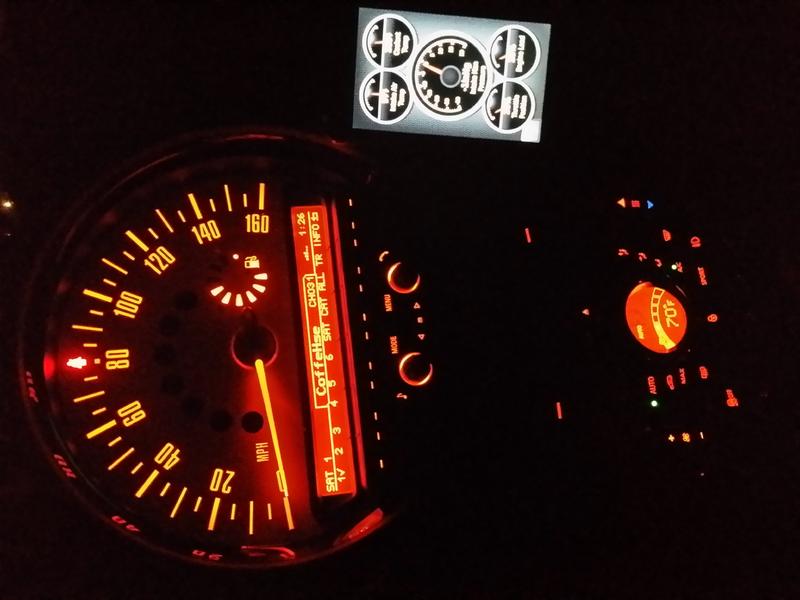

I have a Nüvi GPS with Garmin Mechanic Eco Route, it transmits all data via blue tooth to my GPS https://buy.garmin.com/en-US/US/shop-by-accessories/ecoroute-services/garmin-mechanic-with-ecoroute-hd/prod38354_010-11380-10.html
Photos of my Nuvi system with eco Route, you can configure the screen to any 5 gauges you want, I have my Nuvi mounted on a ProClip.
If you google OBD II Gauge(s) you will find a lot of systems...ScanGauge OBD II Scanner is used by an lot of MINI drivers, Torque OBD is a great system to use with cell phones and some companies like PLX and others making old school OBD plug in gauges but grossly over priced IMO.
Attached Thumbnails Boost Gauge Hose Through Firewall - HELP-20140415_012851_android.jpg   Boost Gauge Hose Through Firewall - HELP-20140415_012740_android.jpg
