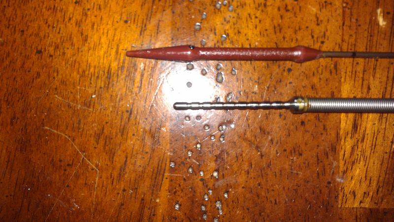

I looked at my newly aquired Craven dipstick for my 2009 Mini Club S again. Here are pics of it, looks like it would read diff then the stock one. Am I not seeing something here? Looks like the GAUGE area it is diff then the stock one.

I just got mine today. Much easier to read. You don't really if the tips line up but you want the full lines to match up which they do.

Its the upper length you should worry about.. the lower part "missing" on the Craven unit might as well say "buy a new Mini"..

I have the top of the dip sticks lined up evenly as they would sitting sitting in the dip stick tube. That said it looks to me the oil level read range is diff between them. I realize that the Craven doesn't have that extra tip on the end like the stocker, that is not what I mean.

On the craven, the end notch is below the lowest read out for the stocker.

That last lower notch on the Craven is bigger then the others, do I only count the oil level against just the smaller notches??

i think i see what you're saying - you actually mean it's too LONG/tall for reading a corresponding full amount correct? i.e., the top full mark in the oem one is above where the craven's even starts to measure?

I've annotated the picture. I'm sorry I don't see the problem.

I was wondering when somebody would point out "FULL" IS THE SAME....the only line that matters!!!
I hope the op was not trying to run his car 1-1.5 low to keep it on the BOTTOM of the stock dipstick....the so called "buy a new motor" zone.....

Ok with this I see it now. Still there is no where from Craven that says that bottom notch and a half is not part of the read zone based on the lines you did to the pic.
I don't and do not run my cars low on oil but just was not understanding this craven stick correctly.

Instructions for the cravenspeed dipstick directly from cravenspeed.com.
"First, make sure your MINI is sitting on a level surface and the engine is cool. If you have been driving your MINI, wait at least 15 minutes before handling the MINI Dipstick Replacement.
Next, pull the dipstick out of the oil tube. Wipe the notched sinker clean of residual oil. Put the dipstick back into the receptacle until it is inserted completely.
Remove the dipstick again, and examine the notches on the sinker.
Like the factory dipstick, the sinker on the Dipstick Replacement measures approximately 1 quart of oil.
Add more oil to your MINI based on how many notches have collected oil. If all notches are clean, add about a quart of oil. If half of the notches are clean, add about a half a quart of oil.
Once you have added more oil to your MINI, recheck the Dipstick Replacement to see the new oil level. Continue to add oil and recheck the level until the Dipstick Replacement indicates your oil level is full."
