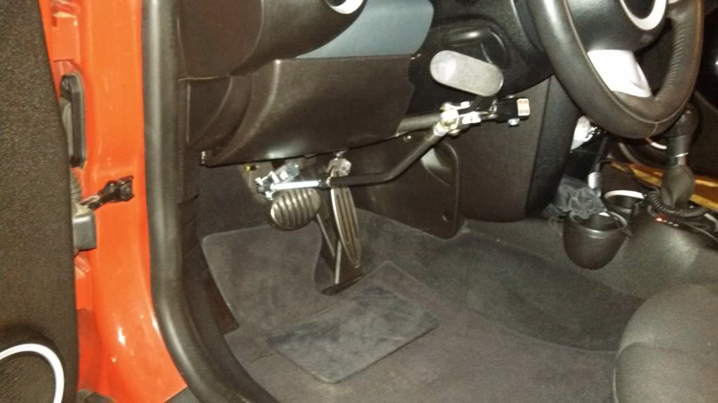

I've got a paceman on order, and I will be putting in Menox hand controls. They're permanent, but less intrusive then most hand controls. Here's a picture of menox hand controls in another car: http://www.camaro5.com/forums/attach...1&d=1290383051
I do not suggest removable hand controls, I believe them to be more prone to malfunction and failure. But, to be fair, I've heard good things about these removable controls: http://www.wheelability.com/
I'm going with NPD hand controls. It uses a push/rock handle and it resides just to the left of the steering wheel. I like this set up because when cruising in a straight line I can hold the handle and still place two fingers on the steering wheel and then use my right hand to change heat/AC controls if needed.
