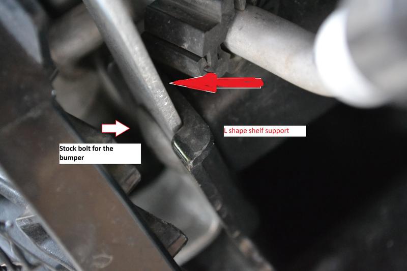

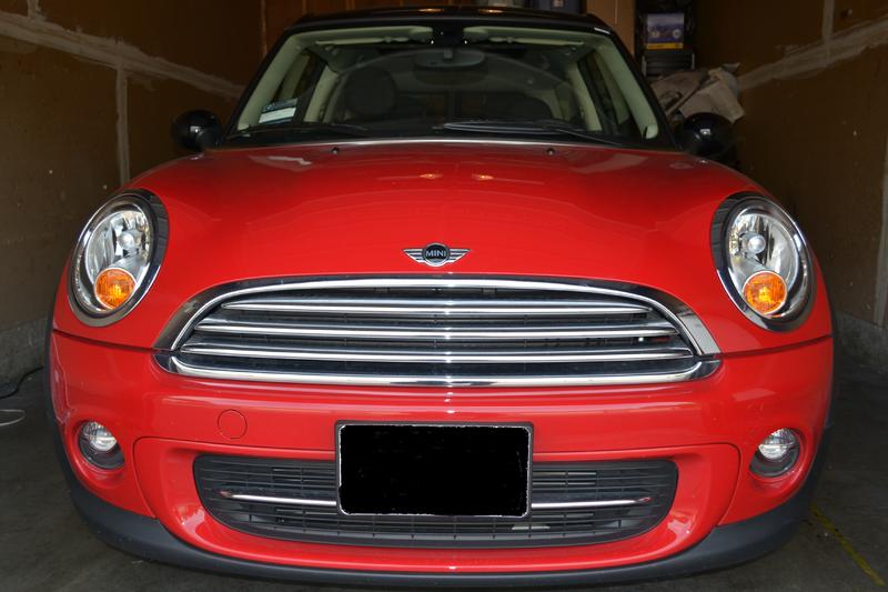

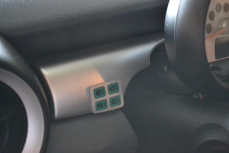

My DIY installation on my Clubbie and my next project on the red justa clubbie.. Light mounting braces came from an L type shelf supoport from home depot, wiring from pepboys, hella 500 black magic with PIAA 50w super white, Hella 700FF with PIAA 100w super white. Tapped to the battery with in line fuses. They do light up the night.

I don't have a link, it's actually my own. At the time when I bought my MCS, the brackets were not available yet at any store, at least for the 2011. You may/might void your warranty though,.
