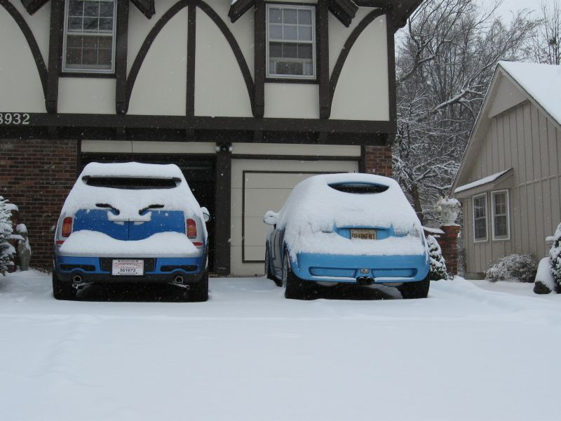

My MINI lives outside too, and while it's probably not as cold here in KC as it is in MINIsota, Wisconsin or Winnipeg, it can get well below zero......
That said, with the bun warmers on it only takes a few blocks to get comfortable.....but on the rare day when I get to park in the garage instead of the wife, it really makes a big difference, especially on those below zero days!
If I lived in one of those cold northern climes, I'd have a block heater in my cars. That way, not only do you have instant heat, it's a whole lot easier on the car when you start it too. Pennies a day for the electricity, and a whole lot cheaper than a garage!
