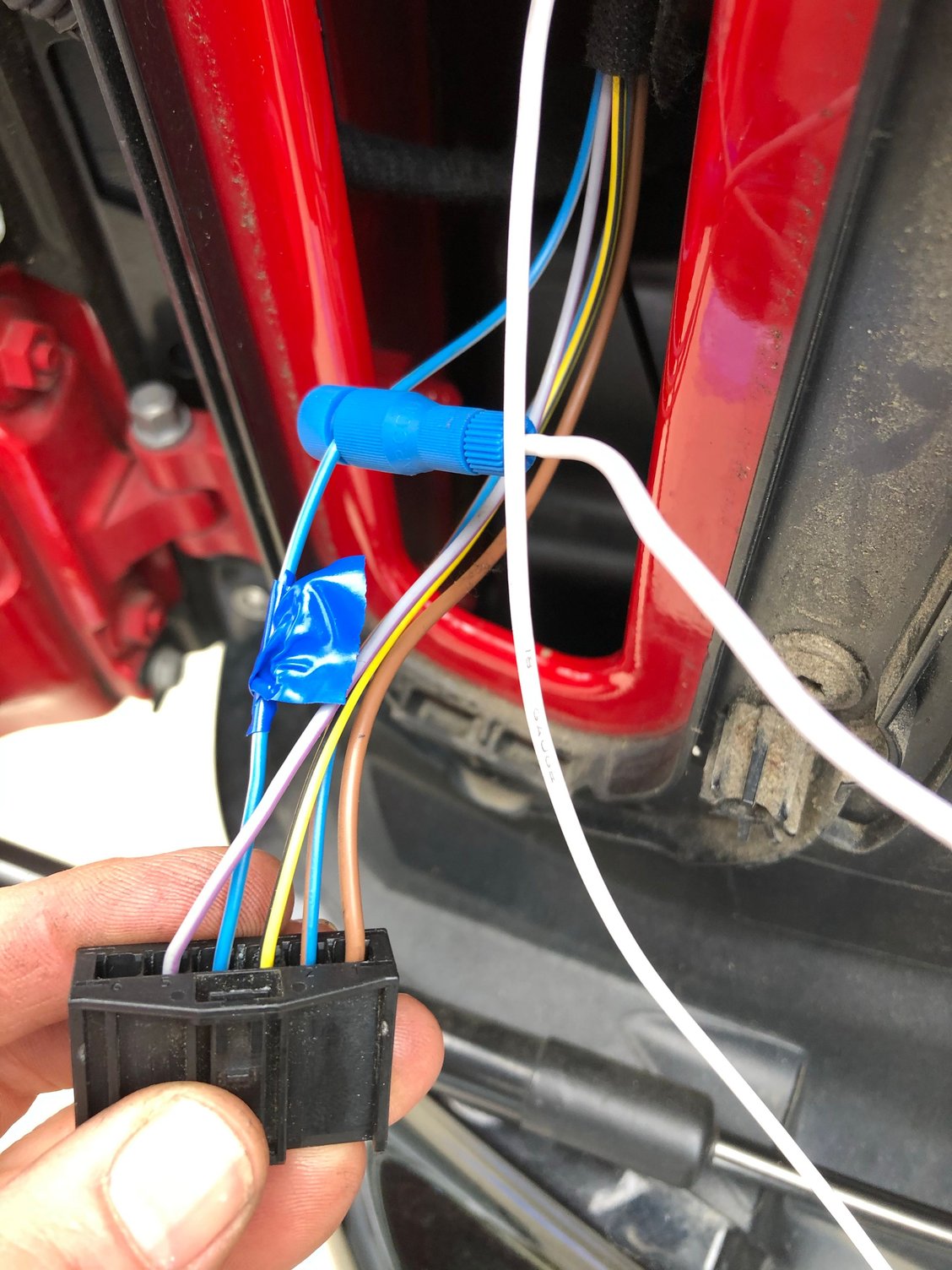

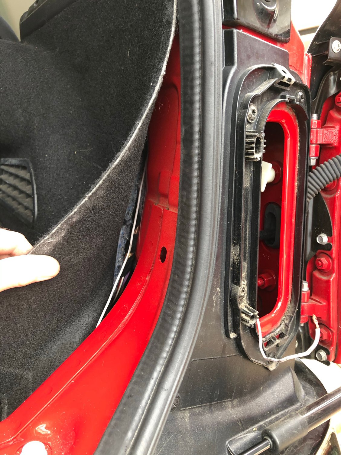

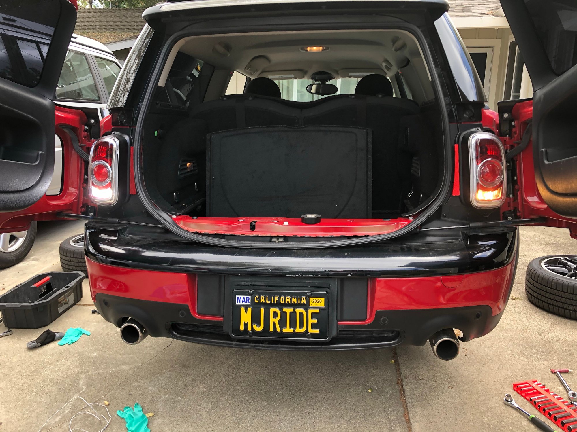

Just in case there is anyone looking to do this by connecting the right to the left, I ended up taking the trunk threshold out, jumpering the Blue/Grey reverse light on the right side to the Blue/Brown on the left side. Running the wire was pretty easy once you have the trim pieces off and can fish it around. I couldn't find a good route under the car since the tail light areas seem to be sealed off from the bottom of the car. A few pictures and the final result.
all done
left side LED, right side regular. Big difference
right side reverse tap
left side fog tap
wire run across the trunk liner

Hi Melissa,
Its been a while, but the pictures don't lie Once you verify your wiring on the right side is the same (I hooked up a test light to the 12v cigarette adapter in the car and put the car in reverse to identify the wire) and then matched on the other side. A quick test to verify is to take power from the 12v socket or connect an alligator clip jumper from the right side reverse terminal and touch it to the left. If you need help I can pull mine back out to walk through it and fix my post

Hi Makeitmini,
My car did not have a factory fog lamp switch, but all of the wiring is there and the bulb socket was in place. I just didn't have a switch in the console.
Getting the Euro left tail gave a clear slot instead of the red slot, so all I'm doing with the jumper is taking the reverse light signal that goes to the right rear to turn the stock reverse light on, and carrying that signal over to the left side to activate the wire that goes to the reverse light on your new euro tail. So the Blue/Grey wire was the original fog light, so it activates the reverse light in your new tail lamp.
No ground or anything needed since that is part of the existing plug. All you're doing is extending the circuit from the right side reverse to your new left side reverse.
Hopefully that makes sense. Happy to help you more specifically if you need it!
