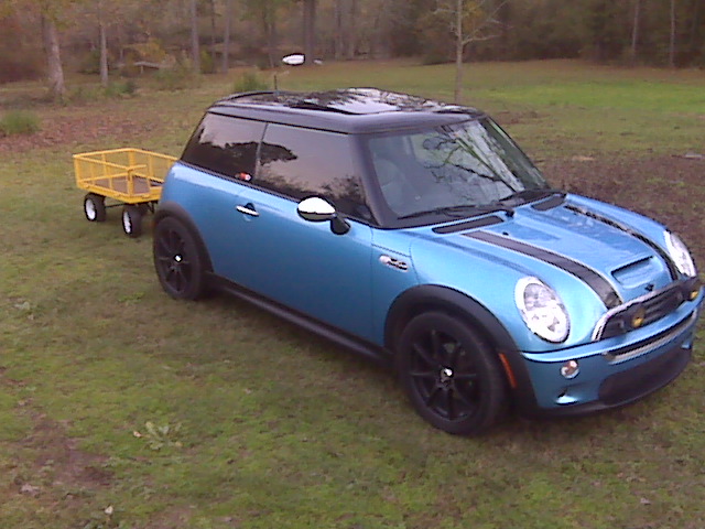

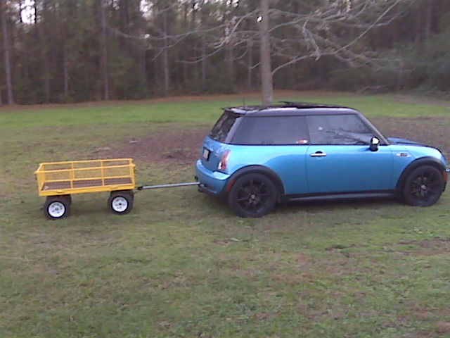

cheap trailer idea
I think my idea needs a little 'tweaking'. At higher speeds (70-80mph) it starts getting a little twitchy. Any ideas on how to remedy this problem?
Attached Thumbnails Mini Do More hitch install-cheap-trailer-1.jpg   Mini Do More hitch install-cheap-trailer-2.jpg
You need to weigh it down with a couple of your neighbor's kids.
