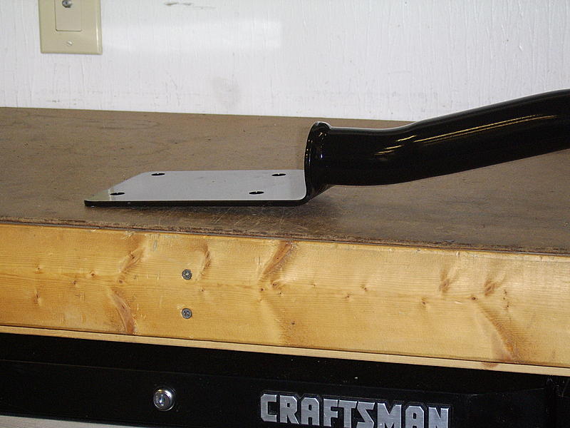

Thanks zsqure. We have identified the issue and why it seems that some have had issues with fitment, while others have not. Zsqure will confirm that when I was over on Sunday, I was able to muscle the hitch onto the car. Took a swift blow with the hand. I agree, this is not the best fit though.
As was confirmed on zsqure's hitch, during the welding process, it seems that some of the hitch mounting plates raised from the heat. See the attached photo. This spring causes the plates to not sit flat and draws the holes closer.
We confirmed that the holes have the correct spacing to each other. In an effort to correct the fitment issues, we have spread the plates 1/8" further a part. And, most importantly, have addressed the welding spring issue. On the test fit this evening, the hitch fits perfectly with no rubbing on the studs.
