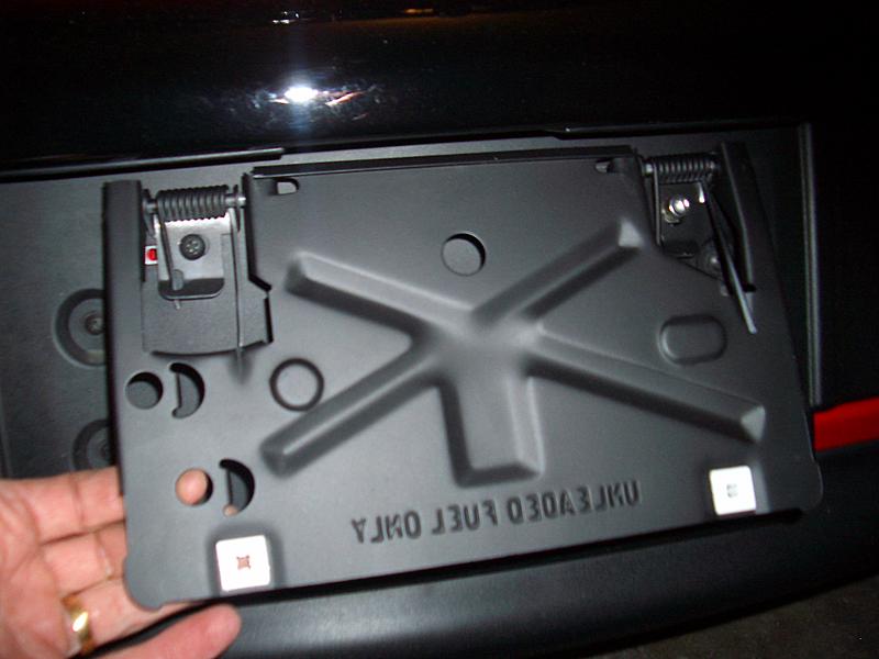

Up-date... Yes I got my spring loaded, flip down $15 plate holder, Painted it black..... But I have not installed it yet... perhaps this weekend. And I'll let you know how looks / works !!!
Old May 31, 2009 | 07:04 PM
  #67
Flytime's Avatar
Flytime
Joined: Jun 2008
Posts: 146
From: Webster NY

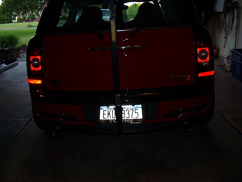

Finally installed my flip up plate holder
All in all this is not bad.
Perfectionists may grumble a bit….. but for now this will work out just fine.
First thing I did was to paint it black as it came with a silver colored plating. I used a primer and then a flat black paint.
It does not come with the plate mounting screws nor the plastic inserts required to fasten the plate. I got these from my local auto parts store.
Installation: The hinge spring force is quite high and there are 2 springs (one on each hinge). I mounted it with only one of the hinge springs functional. It just so happens that there is a nice threaded insert on the Mini’s plate mounting area. The spacing is too wide for US plates and too wide for the flip up plate mount; however it does work nicely to use the insert to fasten the spring loaded hinge. The other hinge mount hole will now line up with the standard plate mount screw hole (no insert, just into the plastic). This is fine for the non-spring loaded hinge. The only issue with this arrangement (and this is what will make the perfectionists grumble) is that plate is not centered.
The plate mounts so that on the top side (flip up mounting) of the plate it inserts into the lip and 2 screws are required on the bottom mounting holes only.
When a draw bar or bike rack is used the plate tilts up and is clearly visible from behind.
Pics attached, sorry for the small size I don’t know how to attach at full size.
Attached Thumbnails Mini Do More hitch install-imgp3105.jpg   Mini Do More hitch install-imgp3106.jpg   Mini Do More hitch install-imgp3107.jpg
Got mine, and I'm wondering about replacing the screws to install the flipup plate - my license plate is fastened to the bumper using metal screws, not nuts - my dealer oibviously just used these screws to drill new holes in the bumper. The threaded insert might accept a ? instead better? what size?
(I'm of the female persuation, I can do a lot of this stuff myself, but correct screw/nut/bolt/washer... terminology is linked to the y chromosome).
thanks.

Mounting screws
TsPoet,
I'm not sure what size screw I used to work with the metal threaded inserts, but it was a metric thread for sure, prehaps an M6X1.5 but that's a guess.
If you are going to drill a new hole thru, then a stainless steel M6 bolt and nut should work just fine.
A good source for stainless steel fasteners are Boat supply stores.
Regarding that female persuation bit, that shouldn't matter. My daughter changes her own oil and does a lot of work on her car.

Centering plate
Installation: The hinge spring force is quite high and there are 2 springs (one on each hinge). I mounted it with only one of the hinge springs functional. It just so happens that there is a nice threaded insert on the Mini’s plate mounting area.The only issue with this arrangement (and this is what will make the perfectionists grumble) is that plate is not centered.
The guy who installed my hitch mangled the plastic insert on my rear bumper, apparently drilling a hole, as instructed was too difficult for him, so he cut out a huge square with a butter knife (or similar) instead.
this meant, when I mounted my spring-loaded plate holder there wasn't enough plastic left and the whole area warped out in a frightening way. So, we removed the plastic center of the bumper to which the license plate mounts and found it to be just a simple plastic sheet. It snaps on on either side, and has 4 self-locking screws surrounding the plate. After taking this off, it's apparent that the threaded insert is just in this cover and doesn't really attach anywhere else. So, we put a thin piece of aluminum about 1" wide along the back of the bumper insert. Drilled through it in such a way to center the plate, and mounted the plate to the now-reinforced piece.
The piece of metal we used, used to line the outside of a shelf on a cheap shelving unit - nothing fancy.
My plate is centered and looks quite nice.
thanks for you help.
