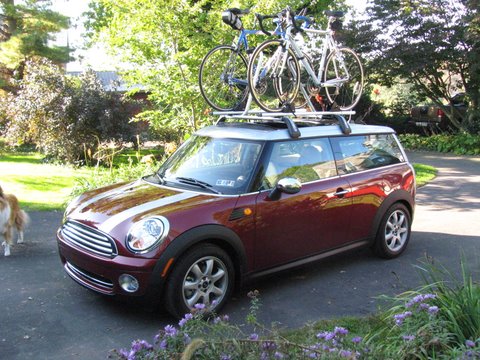

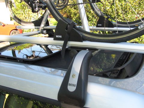

Update on the MINI Bike rack
I loaded up Little Red with bikes today and it worked out well. The MINI rack is pretty easy.
Attached Thumbnails Rack on Clubman - Issues??-img_0214.jpg   Rack on Clubman - Issues??-img_0215.jpg   Rack on Clubman - Issues??-img_0216.jpg

Hi Prost - There is a different set of keys for the base and the bike rack. Both bike racks use the same keys. As you can see from the pictures, it is not a fork mount.
