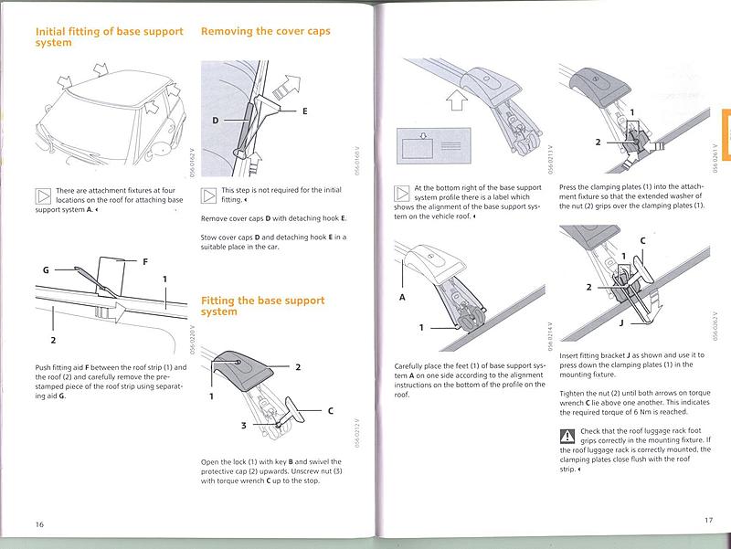

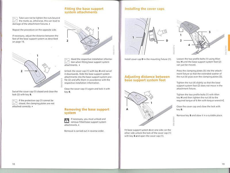

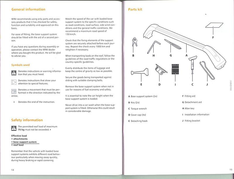

Install Complete - Rack is on our Clubman
I am pleased to report that the new rack was successfully installed on our Clubman this morning by Mini of Sterling (where we bought our car). I had their Service Department do the install because I didn't want any problems in the future regarding warranty, etc.
We arrived at about 7 AM and departed at about 11 AM.
The rack is solidly mounted (testing by hand). Now I just have to find a luggage box we like and figure out how to best mount it to the rack.
The rack came with special tools, hole covers and a manual. I've attached JPG scans of the English language pages from the manual.
My cost for the rack and installation was subsidized by a $ 400 credit that I received when we picked up our car originally. The credit was given due to some small paint scratches caused by the dealer technicians' belt buckles when washing the car after delivery. My out of pocket cost today was $ 75.83.

Very kind of you to post those directions, Gary. I am sure they'll get quite a few close looks. And good for you on that bottom line cost, too - speaks well of your dealership.

Thanks those directions look to be the same as the ones I got with my rack.
