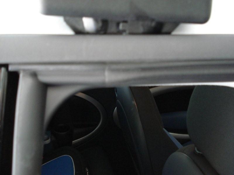

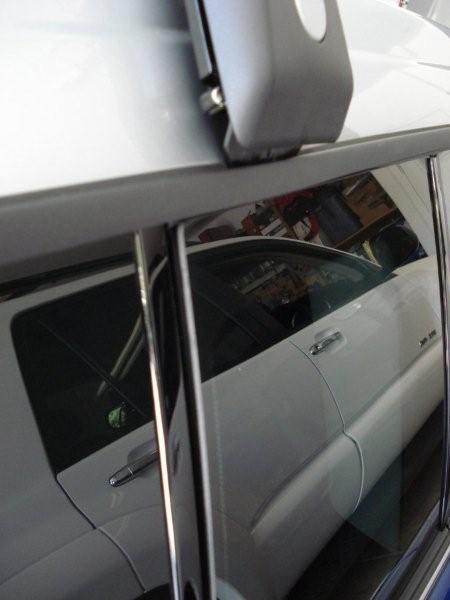

Added some pix
Hopefully, this works. Posting pix on here for first time.
Posted a few shots of the rack connection points
Attached Thumbnails Rack on Clubman - Issues??-2008-mixed-pictures-014.jpg   Rack on Clubman - Issues??-2008-mixed-pictures-015.jpg   Rack on Clubman - Issues??-2008-mixed-pictures-016.jpg

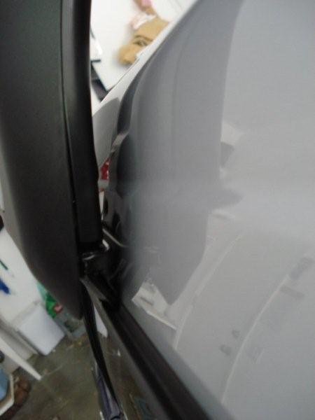

A few more
Here are three more. The first picture is an inside shot looking out thru the club door window at an angle. You can see the light sliver where this is the gap between glass and rubber seal. Going to mess around with it more tomorrow to see if I can get the glass gap issue resolved.
Attached Thumbnails Rack on Clubman - Issues??-2008-mixed-pictures-018.jpg   Rack on Clubman - Issues??-2008-mixed-pictures-017.jpg   Rack on Clubman - Issues??-2008-mixed-pictures-019.jpg

I can not tel form you pictures. Do you have on that has little rubber fins like sticking off the bottom of the cross bar. If so this one needs to be set as the front rack. This will make a difference, the bars are slightly different lengths.
I just checked and yes, the one with the plastic/rubber tabs on the bottom is on the front. I've added a couple of shots as well. Thanks for your feedback

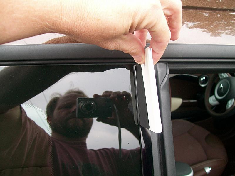

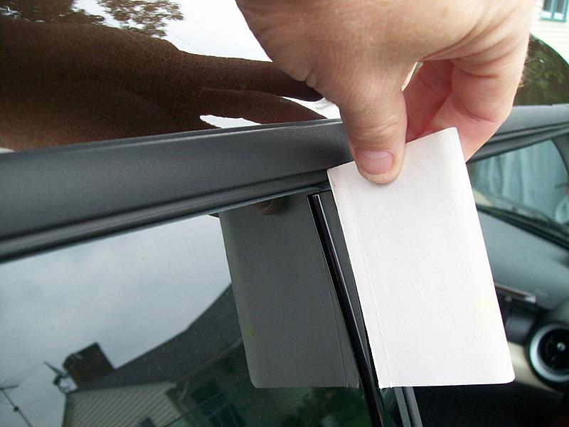

From taking another careful look at the pictures you posted i can not see if the door latch is pulling the front top edge of the door in to far.
I have attached some pictures to show how i tested the flushness of the door.
If the front edge of the door is pulled in to far you will see a gap between the door molding and the straight edge used for checking it.
This would then cause the back edge of the door to toe out as is seen in you pictures, leaving a gap along the back vertical edge of the window.
I do not know how to adjust the door latch system as i have not had it apart but there must be some way of adjusting it.
Two things 1. let me know if you understand what my pictures and explanation show and 2. if you can take a picture or like i did with a mall straight edge.
