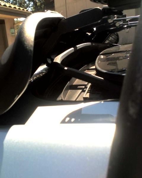

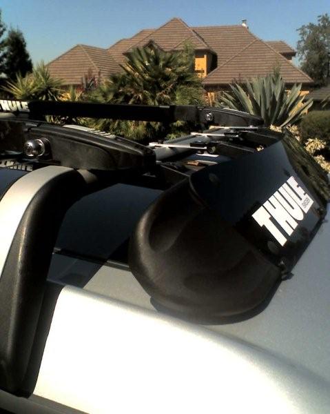

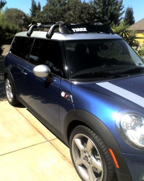

Finished Set Up
Got the remaining Thule bike trays on and got custom mounted the the Thule fairing to the front. I think it turned out pretty well. Sorry for the cummy pix but only had the camera phone. I'll try to take some better shots another time. I extended the fairing out beyond the front of the sun roof so it wouldn't get into the way of opening and closing it.
Attached Thumbnails Rack on Clubman - Issues??-2008-phone-pix-033.jpg   Rack on Clubman - Issues??-2008-phone-pix-034.jpg   Rack on Clubman - Issues??-2008-phone-pix-035.jpg
