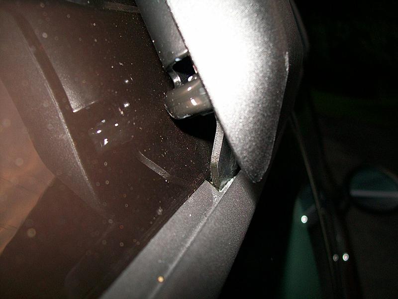

I have taken some pictures of the rack mounting and noticed tha tsome other people have taken pictures as well.
The last picture in this post over on mini2 looks to me as if the mounting has not been done correctly.
http://www.mini2.com/forum/3355380-post48.html
Looking at the last picture i noticed that the mounting plate of the rack upright has not been inserted into the roof properly. This can be compared to the pictures i am posting here.
It is very hard to explain how this rack mounts but once mounted properly there is no way this is coming off the roof. But i will give it my best shot to explain how it goes on in words. am also going to attach a couple of hand drawings showing how the rack mounting uprights look before and after mounting in the vehicle.

i think we need to have people take pictures of the brackets to see how they fit, i have not seen any with the entire pins fully inside the roof.
1. first a frontal picture with the rack cover open (showing the bracket teeth)
2. then one from the side showing how far into the roof the teeth grab.
3. if dealer installed or other.
4. any leaks? pushing down on the gutter?
and post them here. i think we will see how the attachments will vary and give some people an idea if they are better or worse.

So there you go. The Service Advisor told me that I shouldn't expect anything until August or September, but then he added "However, it could come through tomorrow - you never know."
Quote:
"Please be informed that there are fitting problems with the roof rack base support for the MINI Clubman R55.
Due to modifications on the body work (roof area) of the R55, there may be isolated installation issues in conjunction with the rack support part 82 71 0 435 846. We are investigating this issue. Please do not install roof racks on an R55 until we inform you about the corrective measures. We will not block the part from selling as it is still possible to install this part on a R56.
Our colleagues in Germany are working on corrective measures to solve this problem.
Thomas Kurz
Accessory Development Manager - MINI"
This was sent to "MINI Passenger Cars, All Offerings, ALL Regions, All Areas, Sales, Parts, Service, All"
schatzy62 you could also have them call Devon at Ralph Schomp Mini in Denver CO his is my SA. 2 weeks ago I went in to buy the rack knowing of the problems and he told me about the bulletin and talked me out of buying it.
schatzy62, it doesn't appear to be just a fit issue either. From feedback from my SA (who received word from MINI USA) and from postings from others, there also appears to be an issue with the brass screws that you tighten down failing. It has happened to one poster over on MINI2 and it sounds like others have reported it to MINIUSA. Anyway you can confirm this with your source? I'd hate to get the retro kit with brass bolts if they were known to be breaking.....
Using an allen wrench and a torque wrench to test what i considered hand tight and it came out to about 14-15 foot pounds or more than 3 time the torque that the bolt is to be torqued to.
The bolt on mine is steel and the nut that tightens down on the bolt looks to be brass. My hunch is that it is probably brass as a safety feature so that it breaks before to much pressure is put on the rotating plates.
I will be seeing a couple of people about this issue this coming weekend at MOT2008 and with their help hopefully come up with some meaningful information on how to get the rack installed properly as many of the pictures i have seen people post show that the rack was not installed properly.
