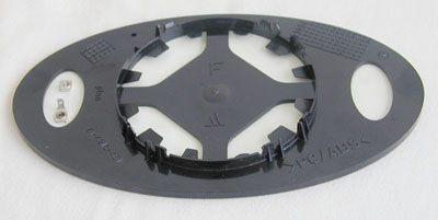

For those of you who are thinking of removing your mirror for the Multivex installation/caulking, here's a picture of the back of the OEM mirror. The large circle in the middle has tabs that clip on to the power mirror mechanism. To remove the mirror, put the mirror in its maximum position pointing in and down. Reach in with your fingers close to the circle and simply pull to release it off the tabs. The two prongs at the left are for heated mirrors and you would pull off the attached wires.
