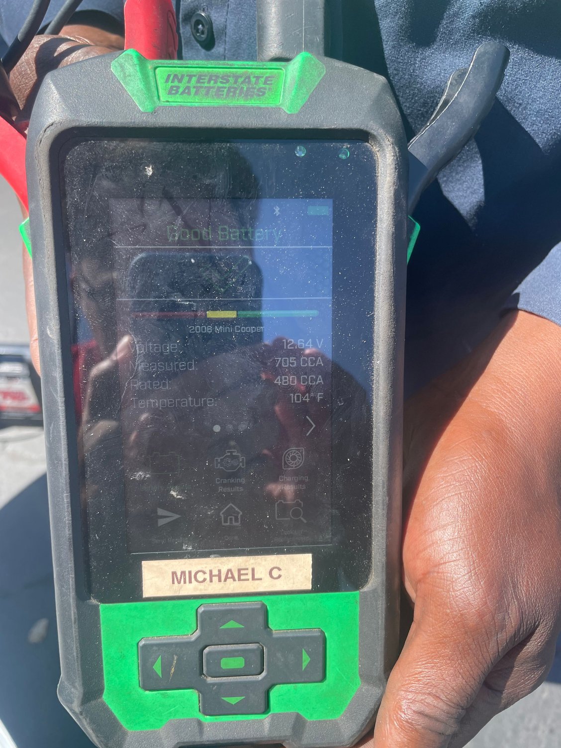

Old Aug 12, 2022 | 10:30 AM
twonius's Avatar
twonius
Joined: Aug 2022
Posts: 8
AAA came out and the battery and alternator checked out ok. Next guess is bad power/ground to the module since the car cranks strong
