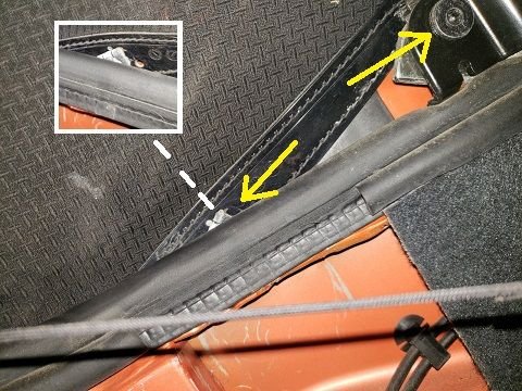

OK, so now that I was able to successfully get the top assembly off of that R52, let me document how I would attack this in the future:
  • Remove the rear hinge screw and clip from the rear side of the top on each side of the car (these are behind a piece of appearance trim/cloth - access would be easier if that is removed, but I don't have those instructions here)

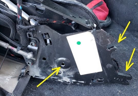

  • Removed the 2 nuts and 1 bolt from each side that secures the front of the top mechanism/frame (these are just inside of the rear quarter window)
This is installed between the inner and outer body panels. This view is of the "out" facing side.
This is installed between the inner and outer body panels. This view is of the "in" facing side.

It is not necessary to remove the 3 bolts from the rear mount at each side at the back of the top mechanism/frame (the best access to these was going straight through the removed taillight openings), as the pivot screws that are removed in the first step above attach the top to these mounts. But, if you're pulling the top from a parts car, these might be good to get as they are unique to the convertible.
Also, there is a mounting plate for the front mounts that attach to the body with a single Torx screw that are unique and could be salvaged, too. I decided to get the rear windows, motors and regulators from the donor I found, as well as the trunk seal and side window body trim. If it was unique to the convertible, I tried to grab it.
