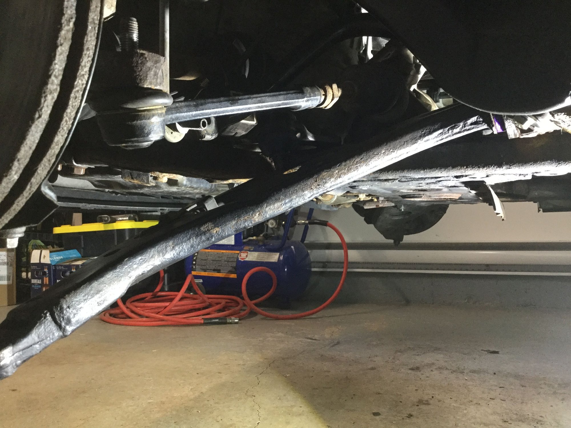

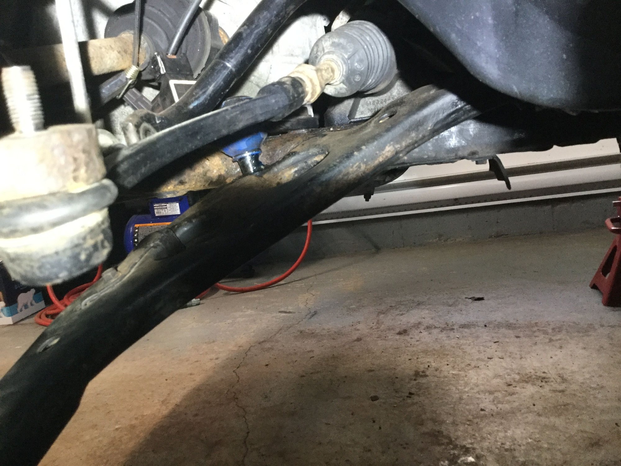

Old Mar 25, 2020 | 01:01 PM
Richwood's Avatar
Richwood
Joined: Jul 2019
Posts: 3
From: Montreal
I do, here you go.
Old Mar 25, 2020 | 02:29 PM
Posts: 36,771
Likes: 2,555
I put the ball joint on the arm first then bolted up with those two bolts and it went on easy. Clean the hole on the lower arm so it slides in easy. It might have some rust build up.

Looks to me like it just needs to be lined up. Stick an Allen wrench in the end of the joint and wiggle it, just a little bit to see if it will drop in.

Thanks guys, that did it. I removed the two top bolts getting the ball joint loose and then fit it into the control arm​​​​. Tightened it a bit and then refitted the top bolts. Fixed the issue. I still don’t know why it didn’t just go in, but hey it is done. Thanks ECSTuning for the recommendation.
