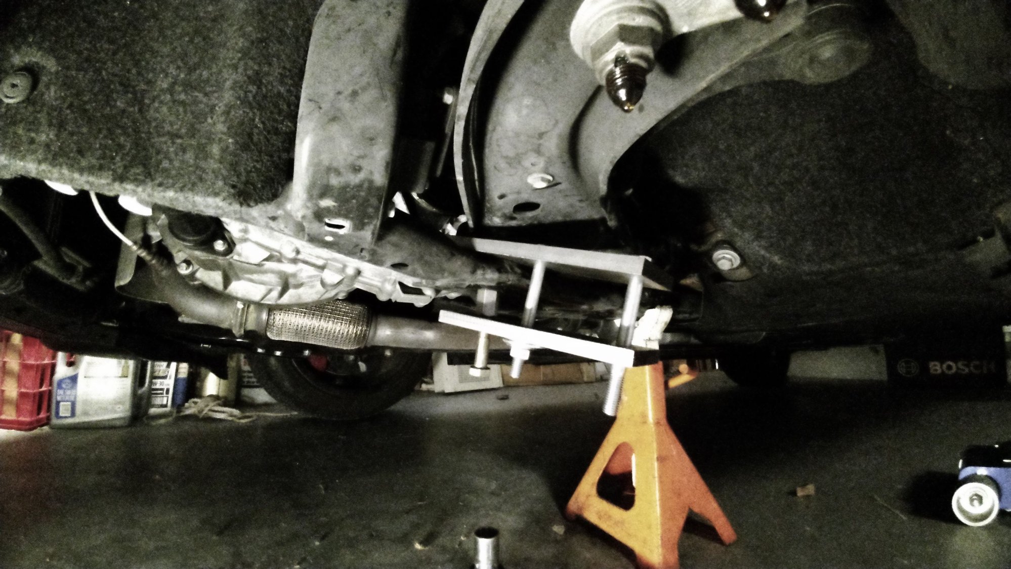

initial try using nuts to open device. That did not work
I adapted the tool to allow the use of a large chipping hammer to apply force directly to the ball joint stud with the tool under maximum force with nuts. This worked..
The tool above was made with an upper plate of 4x8" of 1/2 " plate steel
the lower plate 3 x 8" of 1/2" plate steel. Nuts and bolts 1/2 ", ball joint rod coupling adapter M14 x 1.5 with hardened stud for ground rod driver bit.
My first attempt was with the nuts and enough force was applied to bend the lower plate 1/2". I then adapted the tool to allow the use of this chipping hammer, With max force applied with the nuts it took 15 and 30 seconds of chipping hammer to release the ball joint
I also bought a PMD products puller, greased the rod and used a wrench to pull out my control arm bushings and everything worked fine. Pulled 2 and installed 2 black poly bushings. Nothing broke. Don't use an impact gun on this bushing puller
