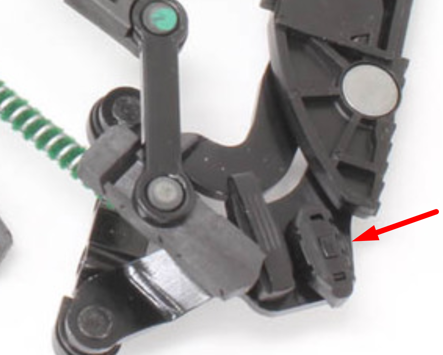

Hi, I have a 2005 Mini Cooper S
on Part Number: 54347174761 there is a plastic clip(in the image below) that has disintegrated on both sides of my Mini.
the mechanism is working fine except it gets jammed due o the plastic clips.
Dose anyone know where to find just these clips?
Thanks,
Rheal

But now I'm pretty sure its because of the lost plastic guide bushings. I've found else where that it doesn't look like MINI sells them separately, but only as part of a $500+ assembly with the slider plates, cables, etc. Seriously? We need (4) 3-dollar clips! Has anybody made a suitable substitute?

Another pic. It's the type hilited, #3. Two bushings each side that I know of.

We talked about this before and that part is only part of the main kit. Might be able to find it on a used part but those will be worn down also a little.
