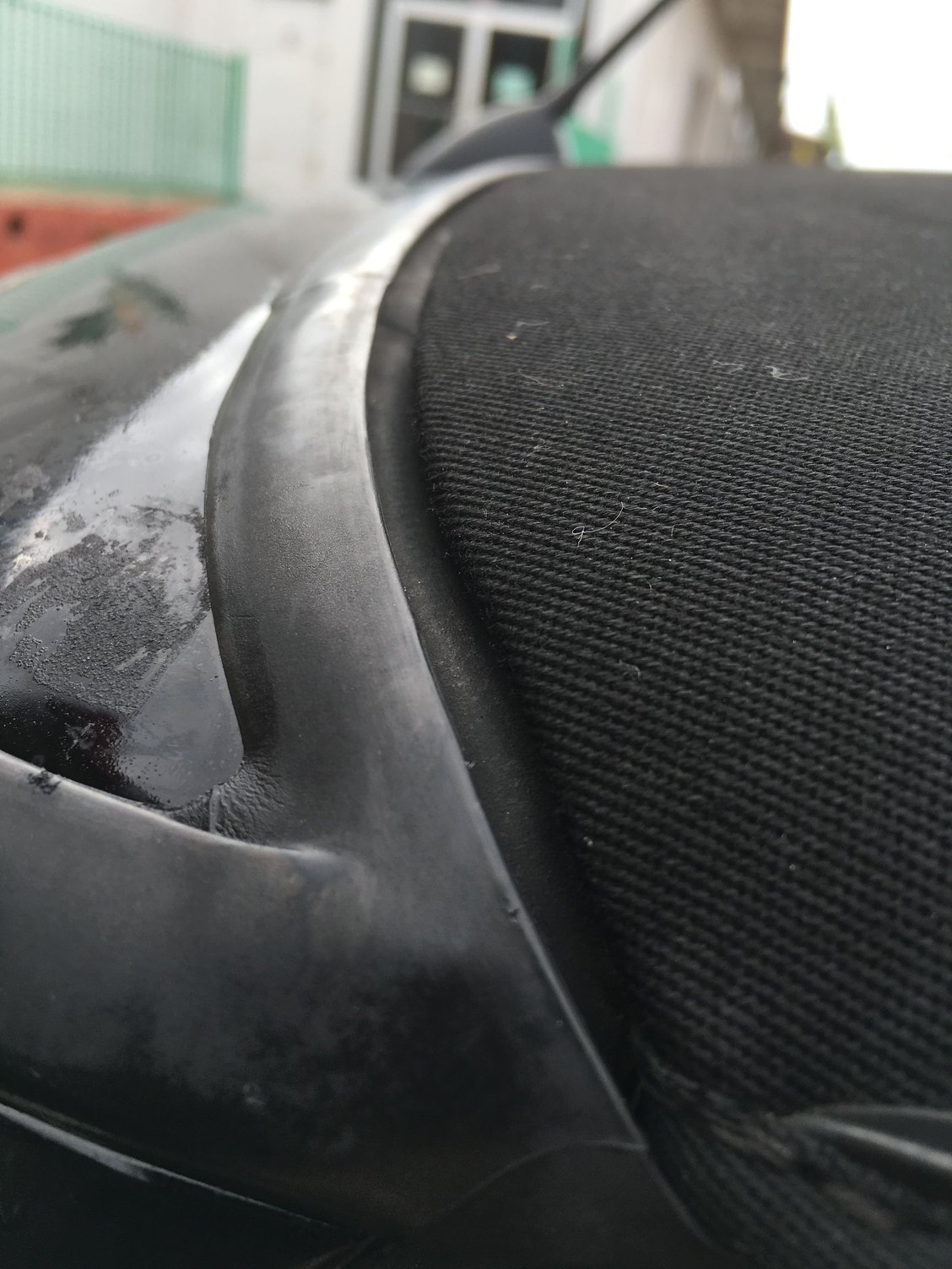

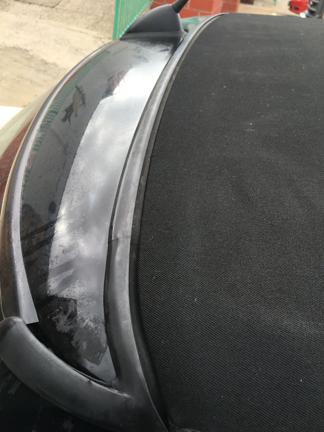

Good morning. I've searched for several days now, and I can't seem to find a solution. My top works great, and I believe both sunroof and convertible mode work smoothly and evenly. However, there is a gap of about 2mm along the entire edge of the top and the windshield header. Most of the threads I've seen discuss a broken cable, so one side is off, but mine is a uniform gap. I tried to do what ECS tuning suggested in another thread for adjustment, by taking off the sunroof motor and pushing the top forward, but I had no luck moving the top. I've replaced the top seal with a newer one, but I don't think that's the issue. Has anyone been able to eliminate the gap?

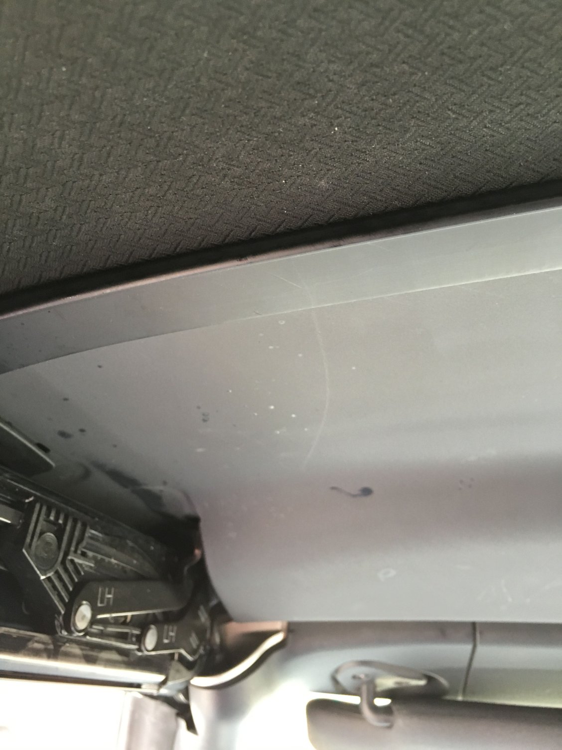

You have to push the very end a little harder as the front parts tilts down a bit on the seal. If you take off the inside rail plastic cover off you will see how it drops a bit and seals.

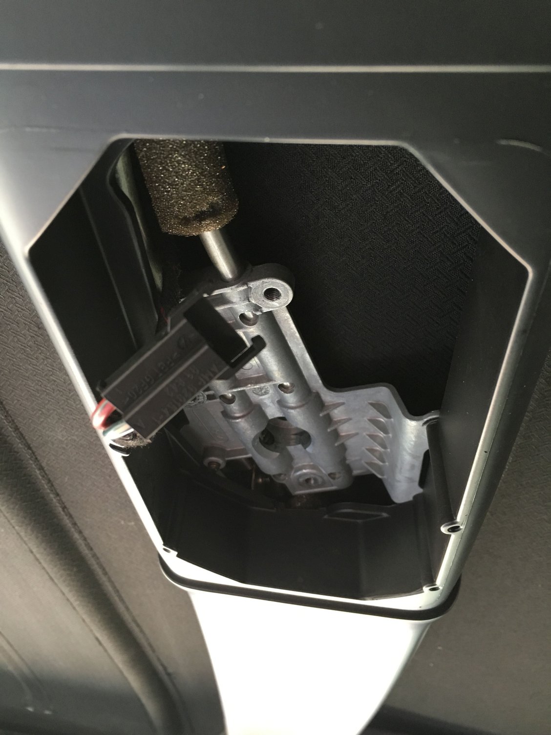

Are these the areas that we are talking about? I've greased the rails and cables and removed the sunroof motor located in the center of the top. The top will not budge, either forward or backwards. Is there something else that I'm supposed to release?

That's pretty close to normal , the top dips down in the front and seals about 1-2mm more. When i had my top replaced, it was set to there. I set it a little more forward with pushing down the front while pushing forward. Then installed motor and cycled the top.
The end movement for closing sets the top down a bit in front hence the pivots on the front portion of the cables
The top with the motor out does not move that easy , its takes a little bump. Make sure to have the top parallel from the seal when you move it.

The cables are exposed where that gear comes out with the motor. They are also exposed when you remove the trim on the inside rails.
I used a flat head to move the one side cable forward while pushing it from the inside. If it does not move like that something is jammed and/or broken.
