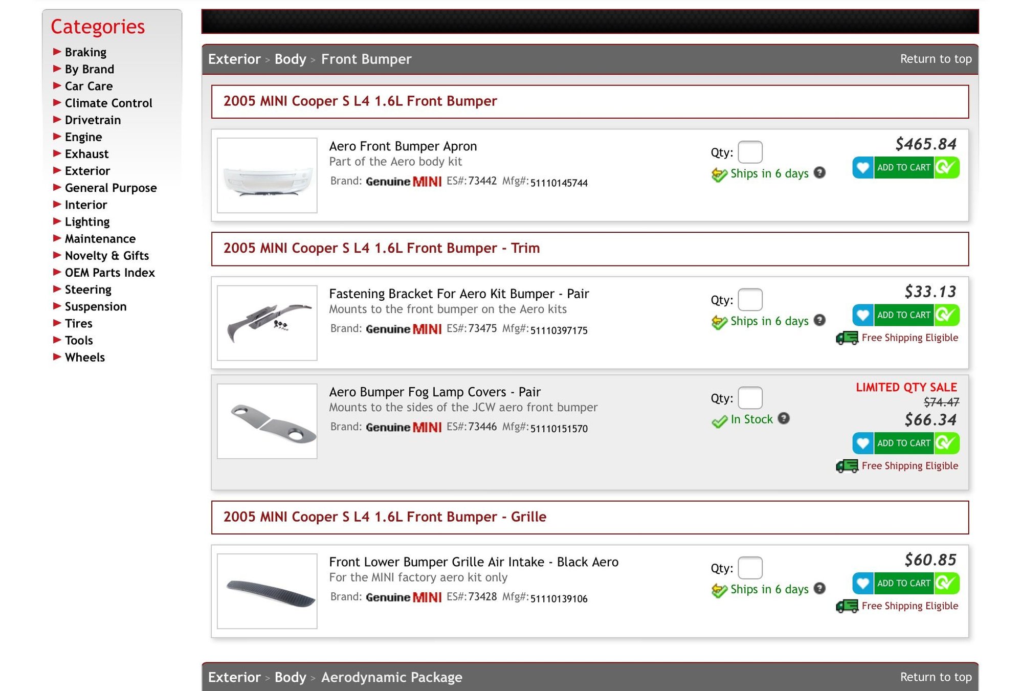

I just picked up an 06 Pepper White JCW R52. I am putting the plate on with a tow hook mount. I was going to fill in the previous plate mounting screw holes in the front. Since that will require a respray, I'm am considering buying the OEM aero front bumper which is primed and needs painting. Are there any other trim pieces required when converting to this bumper?
Wheel arch, spoiler etc?

I think the only things you need are the bumper on top, and the grill. The fog light inserts are optional. This is from the ECS website..

It looks like the mounting kit and the fog light trim is also needed. It's starting to add up. :(
I can't see how the wheel arch is going to transition because I do not think that the lower part of the spoiler is used.

In the ECS description the mounting kit looks like it's included. The fog light trim is not "needed" as it's an optional trim piece. The wheel arches are molded into the bumper which can be painted with the special textured MINI black paint... not sure if it's still available though. The lower spoiler from the standard bumper isn't used. Look at some pics of cars with the aero bumper and you'll see how it all works.
