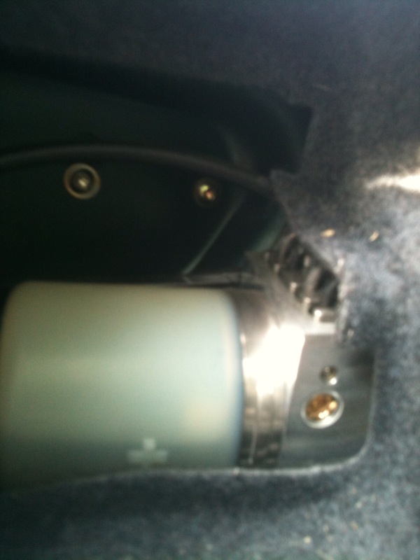

Update: Took the car to a Mini specializing mechanic in LA who did not charge me to look at it. They spotted that the motor was super low on hydraulic fluid so they think there is a leak somewhere thus making the pressure zilch so it won't move all the way.
I called Southbay Mini and they said they would do a "dealer" check for FREE~ OH MY GOD FREE! So I am going to take it to them for a look-see.
Supposedly you have to replace the motor however the dealership sales manual sells the fluid so there is a way to replace that. That AND this dealer thinks Mini USA may help with the cost. (yippee best news I've had since I bought this car)
If you check the motor for the top it is on the left side in back and it is a whitish container you can look at with a flashlight. See if it is full or less than full and that may be your issue as well.

Well it looks like the Hydraulic fluid level is ok. I was really hoping this was the issue. I have a BMW/Mini Service DVD and it gave instructions for filling it.
I am attaching a picture of the level just to see if anyone else has an opinion on it.
Now I think it is probably the Cable harness that I have seen mentioned several times. I really need a picture of this thing so I can locate it.
